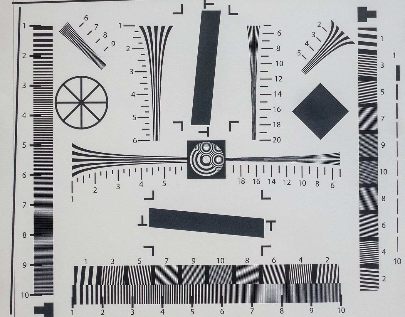

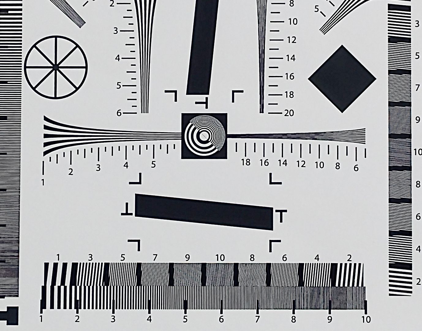

OK, just shot a resolution target with Canon 7DII (c.2014), Canon S110 (c.2012), and Motorola Z3 smartphone (c.2019)
All shots framed to capture full height of target at full height of frame, then cropped down to about same height, to show resolution target in finer detail areas.
  1. 7DII 20MPixel Canon 100mm at f/5.6 ISO400 (RAW) 5472x3648
  2. S110 used max FL setting at f/5.9 ISO400 (RAW) 4000x3000
  3. Motorola used zoom at about 4x f/2 (JPG) 4000x3000
The results:
7DII...
IMAGE: https://hosting.photobucket.com/images/i63/wiltonw/7DII_target-1.JPG?width=1920&height=1080&fit=bounds
S110...
IMAGE: https://hosting.photobucket.com/images/i63/wiltonw/S110_target-1.JPG?width=1920&height=1080&fit=bounds
Motorola Z3...
IMAGE: https://hosting.photobucket.com/images/i63/wiltonw/Motorola_target-1(2).JPG?width=1920&height=1080&fit=bounds
At right, I see deterioration at level 10 in both 7DII and S110, deterioration beginning at level 8 in Z3
At center, I see no moire in 7DII and S110, and moire in Z3
Draw your own conclusion about IQ of smartphone

I did not control the viewing size of the images. All were brought into LR at pixel dimensions listed, then cropped down to about same vertical photo area, then output to 1600 x1200 JPG for posting.
I just reviewed the three orginal but cropped to same vertical images in LR, and I feel that the posted JPG pretty much reflects differences visualized in LR Develop module for each image. I both viewed full image, and with LR one-click zoom, and quality of image did not change.
I believe that what the results represent is that IQ is NOT simply about pixel count. The lens has to deliver quality to the pixels, or else the pixel count was wasted because the lens was the limiting factor. The fact that both S110 and Z3 images were 4000x3000 as captured is indicative that they should have been similar in result, with perhaps better results from the 7DII. But reality was that 7DII and S110 are quite similar, and the Z3 is considerably inferior in detail resolution.

I just took a Z3 photo, moved it to desktop PC...no black or grey 'frame' around the image...the image ends with no frame. You comment puzzling.
Your comments about sensor size related to IQ are well known phenomenon...smaller pixel = less gathering power of photons, so less 'signal' and with same inherent circuit noise this results in lower signal:nose ratio.
Assming same pixel count in 10sq.mm sensor vs. 100sq.mm sensor vs. 500sq.mm. sensor shows same detail resolution but with generally proportional benefit is signal:noise, all else being equal (assuming lens optics presents proportionally higher line-pairs per millimeter MTF).
But the application of more effective noise processing of the image can diminish observed differences...the 'old' 8Mpixel sensors seemingly more noisy than today's 30Mpixel images because noise reduction processing has improved over the past 15 years, and maybe a bit of inherent circuit noise reduction as well. That is how we now get higher ISO values with less noise now.

Jul 06, 2021 22:21 as a reply to  @ Wilt's post |  #24
With exposure increased.
IMAGE: https://photography-on-the.net/forum/images/hostedphotos_lq/2021/07/1/LQ_1110850.jpg
Image hosted by forum (1110850) © kf095 [SHARE LINK]

Very odd. You shot this photo of a grey diamond, and it outlined the outside edge with a black line?!
I just shot a grey rectangle (18% grey card) wih my Motorola Z3, and all I got was a grey rectangle!
kf095
Out buying Wheaties
7,474 posts
Gallery: 63 photos
Likes: 1078
Jul 07, 2021 08:28 as a reply to  @ Wilt's post |  #26
I did not shot anything.
It is screen shot from your Z3 image with increased brightness to make it easier for you to see what Z3 gave you.

It is pretty well known that phone cameras/software usually heavily edit images before saving them. There should be little surprise that phones, even today, don't quite deliver the IQ that we are accustomed to with our dedicated digital photographic devices. I am surprised that we would even really bring phones into the mix for this discussion, as every manufacturer, and even down to the model, could have a variety of pros/cons to the images they provide. Darkening edges of high contrast areas is just one trick of the trade with photo imagery on a mobile device, in an attempt to show how "detailed" and how "great" the phone might be at photography.
I find them to be great for "capturing the moment" and for "memory shots", but beyond that, if I am sharing with others at a scale greater than the size of a phone screen or instagram/facebook's limitations, I always pull out the Canon gear.

Still odd. Still puzzling what is happening. In the target which was shot with 3 cameras, the 'diamond' area in the target is solid black, and conveyed that way in all three photos.
You do not mention what software or web browser is displaying what you are seeing. I admit I do see a hint of it in the Z3 image (of the triplet embedded within my earlier reply) while I am typing this reply and POTN makes it light, while typing this reply.
I do not see a hint of the black border in either of the JPG from Canon cameras. So it must actually be within the JPG file generated by the Motorola Z3 itself, whereas the Canon images are both JPG generated by Lightroom.
(edit: I guess TeamSpeed's reply states the Why of the outline.)
