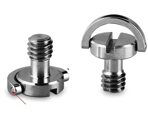

Can’t seem to find the answer,these particular ones are made by Smallrig,but would be open to suggestions to a better screw of this type.

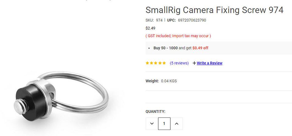

The issue is the unknown load bearing strength of the screws which attach the D-ring to the screw head (red arrow)
IMAGE: https://hosting.photobucket.com/images/i63/wiltonw/Smallrig_alt.jpg?width=590&height=370&fit=bounds
Oddly, a visit to smallrig web site shows no products as you depicted. There is a different type of product on their web site
IMAGE: https://hosting.photobucket.com/images/i63/wiltonw/Smallrig.jpg?width=960&height=720&fit=bounds
which inherently I might have a greater degree of faith about its suitability of the strength of the O-ring, which appears to be larger diameter in cross-section than the pivoting screw (red arrow)
For either product, the fundamental insecurity I fear is that the strap attaches in such a way that a swinging camera can unscrew the thread out of the tripod socket in the camera base! That, to me, is a bigger disqualifier than the question about material strength. :-(
Any product put to the use that you are considering HAS TO NOT UNSCREW itself via any rotational motion that might be exerted by the strap. I would rather use a screw like the one shown to attach an antitwist baseplate to the bottom of the camera, and the shoulder strap attaches to the baseplate, and any motion does nothing to loosen the thumbscrew which holds the plate to the camera. Something like this (although it lacks the anti-twist feature)...

If the D-ring tightens and loosens the screw in the 1/4-20 tripod hole, how can you NOT be concerned about a strap putting torsion on the D-ring and unscrewing it when the camera swings around at the end of the strap?!
