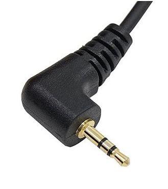

OTOH, what really reduces chance of accidental pull out is the OFFSET design of the N3 cord. If the 2.5mm jack cable was like this, similarly offset, there were not really be a strong advantage of N3 vs. E3
IMAGE: https://hosting.photobucket.com/images/i63/wiltonw/offset_jack.jpg?width=590&height=370&fit=bounds
I frankly consider the potential damage to pins in the N3 socket on the camera a liability to the N3.
