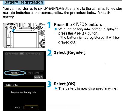

Feb 18, 2022 09:47 |  #26
I never even knew there was a battery registration. :eek:
Do most people register their batteries?

Feb 18, 2022 11:24 |  #30
i-G12 wrote in post #19346048 (external link)
Earlier models of Canon cameras have no registration process. Later ones, like the Canon 90D have a procedure documented in the user manual
IMAGE: https://hosting.photobucket.com/images/i63/wiltonw/batteryreg.jpg?width=590&height=370&fit=bounds
What the true purpose of registration is, I do not know.
The 'worth it' assumes that there is some TANGIBLE BENEFIT to using the manufacturer brand rather than aftermarket, so that one can compare benefit derived vs. greater cost. Has anyone in the thread expressed any tangible benefit?!
I can only determine that registered batteries allow the camera to tell you last date of use of that battery.
