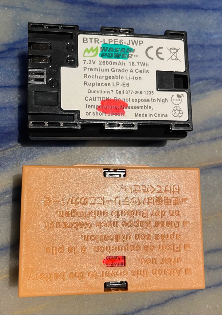

I just bought a pair of Wasabi LPE6-JWP batteries, advertised as 2600 mAh, from the Wasabi website. They arrived WAY ahead of the prediction.
Out of the box they had 50% charge according to the Canon charger. I didn't time how long it took to get to 100% but it wasn't that long.
They came with covers which had the indicator cutout, but there was no marking on the label that made the cutout useful. I took some red and green marker and colored the areas that would be shown depending on how the cover was installed. The lower battery is my existing Vivitar battery with the cover on it; the second Wasabi is staying in the box for now.
