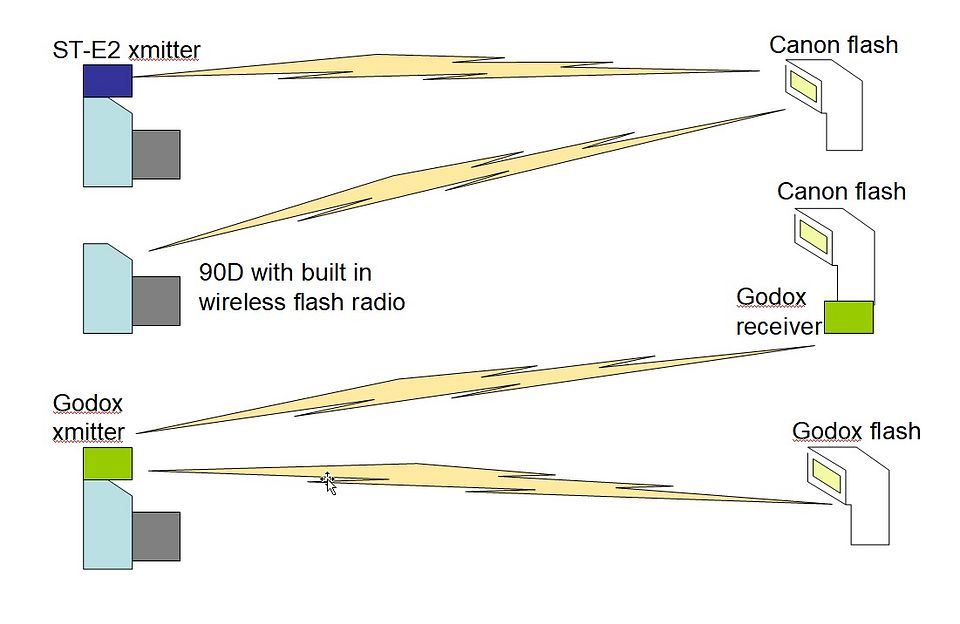

Mar 09, 2022 11:49 |  #9
Precision308 wrote in post #19353527 (external link)
Thanks for all the replies. It is apparent that I have not been properly educated on flashes. Didn't know I needed a transmitter. This is all new to me and I don't have anyone locally to help. Would the following transmitter work?
https://www.adorama.co​m/fprrr2rc.html (external link)
Thanks in advance
This will pictorially depict the flash situation which is being dealt with. The issue is that while different brands of flashes claim 'Canon eTTL compatible' for preflash and automatic flash power control when mounted on the Canon camera hotshoe, there is not a single remote flash 'radio communication' standard...'Canon radio' remote is not compatible with 'Pocket Wizard radio' remot or 'Godox radio' remote.
IMAGE: https://hosting.photobucket.com/images/i63/wiltonw/Flash_compatability_.jpg?width=960&height=720&fit=bounds
What I have not depicted is that EARLY Canon flash (e.g. Canon 580EX) did NOT have any remote radio capability, while later models of Canon flash had an included radio remote receiver (e.g. Canon 600EX-RT)
