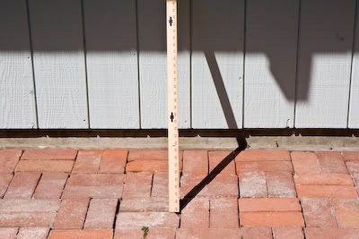

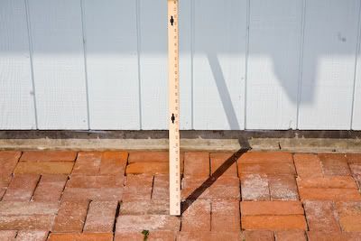

Flash on a sunny day hardly increases exposure in sunlit areas! Assuming typical Sunny 16 conditions with ISO 100 setting...
  1. Sun illuminated area is 1/100 f/16
  2. Shade illuminated area is usually about 1/100 f/5.6
  3. If using Canon 580EX at 50mm FL setting, at ISO 100 its Guide Number is about 135...or 15' at f/9...about -1.66EV compared to the sunlit area. So shadow areas is f/9 at 15', brightened considerably from f/5.6
  4. But if you think of f/8 as 'one part of light' and f/16 as 'four parts of light', the area getting both sun and flash gets 'five parts of light' or scarcely 0.25EV brighter than sun alone! (something that gets 'four parts of light' has to get 'eight parts of light' in order for it to be 1EV brighter!)
How much brighter is demonstrated with these two photos:
First photo show shadow cast on sunlit wall by a ruler and an overhead deck...

Second photo shows how might lighter the same shadow areas can be with flash addition.
IMAGE: https://hosting.photobucket.com/albums/i63/wiltonw/IMG_1052-3.jpg?width=960&height=720&fit=bounds
IMAGE LINK: https://app.photobucke​t.com …96-45bb-9a52-d2b40c759b31  (external link)
...the brighness of the shadow area and the addition to ambient (sunlight) base is dependent upon flash-to-subject distance.
