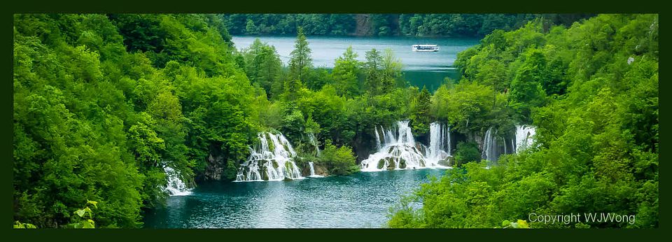

One can get very large photos made even though the original resolution is limited! I took a 12MPixel image from a P&S, resized it to provide 250 pixels per inch on a 12" x 60" canvas, printed from a 3000 x 15000 pixel JPG file size.
I couldn't locate my earlier post on POTN, so here it is again.
IMAGE: https://hosting.photobucket.com/albums/i63/wiltonw/POTN%202013%20Post%20Mar1/.highres/IMG_3764bc_zpszvw7n2c5.jpg?width=960&height=720&fit=bounds

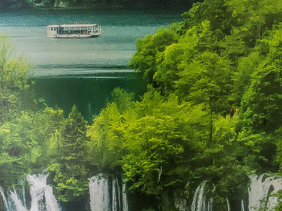

And photographing a small section of the canvas print on the wall, one can see the detail of life rings mounted on the boat in the distant background
IMAGE: https://hosting.photobucket.com/images/i63/wiltonw/Plivice(2).JPG?width=960&height=720&fit=bounds
