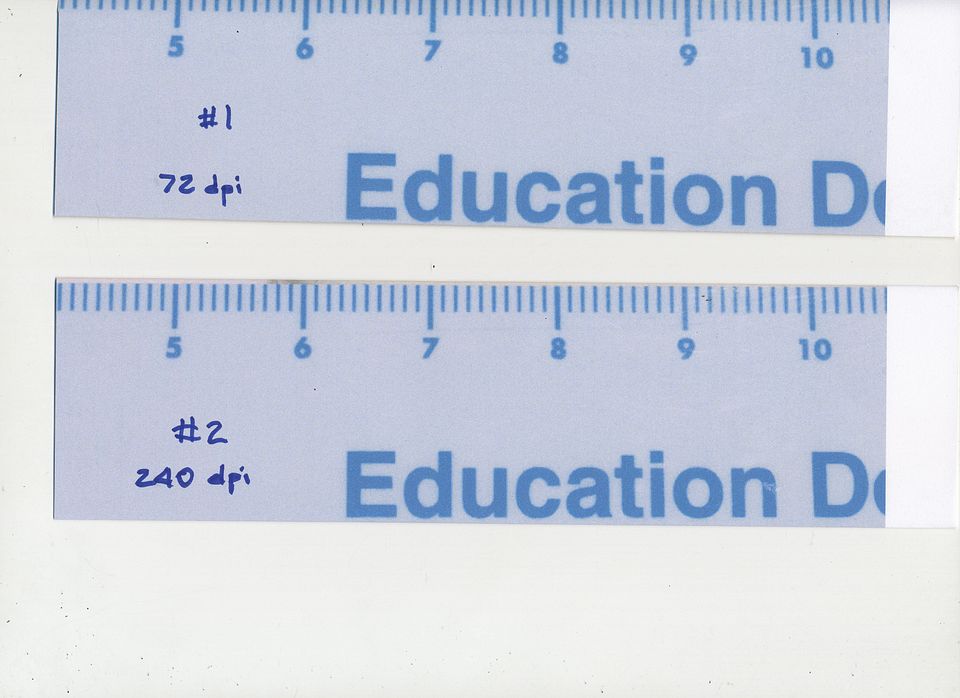

I shot a RAW photo of a metric ruler using Canon S110, I brought that RAW file into Lightroom. I did some minor adjustment to Exposure and Clarity control, then I created a Virtual Copy of that image and output two JPG files.
I then used the EXIF editor from Opanda to alter the DPI value of one of the files, while I left the Lightroom default DPI data alone in the EXIF of the second image. Both images are identical in original pixel count (1600 x 599)
Here are the two images as screen capture regions, having different DPI values in the EXIF of the files.
IMAGE: https://hosting.photobucket.com/images/i63/wiltonw/Ruler_dpi_test_(2_of_2).jpg?width=590&height=370&fit=bounds
IMAGE: https://hosting.photobucket.com/images/i63/wiltonw/Ruler_dpi_test_(1_of_2).jpg?width=590&height=370&fit=bounds
I see zero difference in the display of two images on monitor, one with '72' dpi embedded in its EXIF and the other with '240' dpi embedded in their EXIF data.
Then I used the Canon-provided Zoombrowser EX software to make a print of both images, output to 8.5" x 11" plain paper using my Canon TS6320 printer, and I then folded both images so they would fit simultaneously on my Canon 8800F scanner, resulting in this JPG scan file
IMAGE: https://hosting.photobucket.com/images/i63/wiltonw/Printed_versions.jpg?width=960&height=720&fit=bounds
I see no difference in the scale's size or areas printed, between the image with 72 dpi in its EXIF and the image with 240 dpi in its EXIF. DPI only matters for offset press output (magazine/brochure printing) and has no effect upon home printer.
The DPI value can have effect upon a different pixel count in a JPG file during output phase from Lightroom, if you tell it 300 dpi on 8" dimension the file output has 2400 pixels, and if you tell it 75 dpi the file output has only 600 pixels in that same direction.
In my example, the pixel count was IDENTICAL and only the DPI value within EXIF was different.
Not saying you are wrong in your statement, merely proving that a statement differing from yours can be proven to be true, as well.
kirkt
6,602 posts
Likes: 1556
Location: Philadelphia, PA USA
May 06, 2022 18:51 |  #10
Wilt wrote in post #19374747 (external link)
Kirk,
Your print software is automatically scaling the image file that is 1600 x 599 pixels so that it will print to the paper size you specified. Your PPI tags are therefore meaningless because the software is determining the PPI to scale the image file into the print size.
Some folks set the size of their prints manually because they want the print size to be exactly what they specify, at the PPI that they want for the print quality they are targeting - the explicitly set PPI tag will still determine the print size for the desired print quality.
As I said before, it does not matter how you manipulate the previous expression that relates image dimension, print size and PPI - that expression is what governs the relationship of image size in pixels to print size in inches (or centimeters, or miles, or any physical length dimension).
Your workflow uses software to automatically determine PPI because you specify the print size (in inches) for a given image size (in pixels).
As you noted, PPI has no effect on how an image is displayed.
