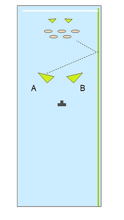

I thought about this situation and created a drawing to help in the analysis
IMAGE: https://hosting.photobucket.com/images/i63/wiltonw/Dancestudio.jpg?width=960&height=720&fit=bounds
Depending upon what your concern specifically is, there may not be an issue at all to worry about. I am assuming your concern is about the reflectivity of the mirror along the side wall, and its impact upon the lighting put on your subjects, and that your concern is not about seeing reflections of lighting equipment in the mirrors.
If we assume light A is Main and it is 8' from subjects at scene right, the distance to the mirror is an added (guestimate) 3' to the mirror, and then another 3' back to the subjects at the right. So the intensity of light falling directly on subjects from light A will be about 0EV (relative intensity at 8') while the light reflected by mirror and back to the subjects (as reflective Fill) is maybe -0.66EV (total distance 14'), because the source is a softbox so falloff is not Inverse Squared but closer to Inverse Linear. Meanwhile, light B is not really falling on the mirror as it is aimed somewhat away from that wall. So the mirror is acting to provide a mild Fill which makes the subject illumination a 'low subject contrast (2:1)', but light B is already doing that somewhat! If anything, the mirror bounce is further reducing lighting contrast, and you might simply want to drop light B power by 0.5EV (-1.5EV relative to Main intensity) so that lighting contrast is not too flat.

Thank you, Wilt!!! Wow, you are basically spot on with the diagram and that analysis is amazing. So helpful. This is basically where my mind has been ending up for a best case scenario, hoping it might be as simple as adjusting the B light power down a bit to compensate for the extra fill.
The lights for the backdrop will be off to either side a bit, but I have some folding black posterboard flags for those to help minimize their reflection. As far as the reflection of the backdrop itself goes, I'm curious as to whether it will function similar to an additional backlight from the mirror reflection... hopefully not too powerful.
A little time to test this weekend will help make sure there aren't any other adverse reflections I need to consider. I'll come prepared with something to cover the mirrors a bit in case my angles are off a bit or I need to control the effect of the big white backdrop.

The backdrop will provide -1EV as bright simply because of the reflectivity of white surface (vs. a mirror), further intensity reduction will occur because of distance between it and the subject...which is why you do NOT want to position your subject just 2-3' from the white backdrop ordinarily. In the photo the shoulders of the subject should not be visibly brighter because of reflected light from the background. It you use a flashmeter, its intensity at subject position while aimed at the back wall should be less than the intensity facing the frontal sources.

Nice photo. Glad to hear that what you encountered for reflections was a non-issue, as I had analyzed...reality matched theory!
Was the mirror wall on subject's right or left...obviously Main was on subject left. What was power setting that you used for Fill (vs. Main setting)?

Setup was a mirror image (hehe) of your diagram. So, mirror wall to subject's right.
If I remember correctly the key light was usually full power through a 40" umbrella, and the fill was a 46" photek soft lighter umbrella ranging 1/2 to full power depending on if I had to pull it back to fill more space. The two strobes lighting the background were between 1/4 and 1/2 power.
