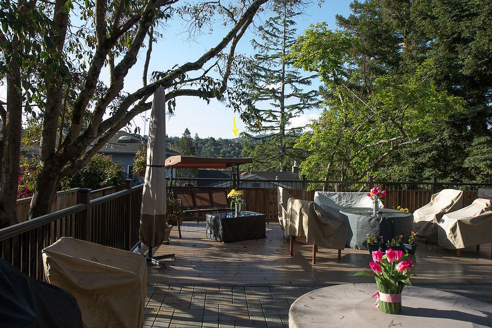

I will express a dissenting opinion on the purchase of an ultrawide WA to use for landscape photos, as a general use lens for that purpose.
Ultra-ultra wide angle has a use, but probably NOT what you think!
Here is a shot with 55mm FL on APS-C format camera, just taken from my backyard, looking across to a hillside less than 1 mile from camera position. Behind that hillside is a second hillside, about another 1 mile back.
IMAGE: https://hosting.photobucket.com/images/i63/wiltonw/IMG_6028-1.jpg?width=960&height=720&fit=bounds
Note the houses (the two small white shapes) on the second hillside to which the yellow arrow directs your attention. Note also the house seen on the first hiillside (the brown shape below and to the left of the two white shapes).
Now a shot with 17mm FL on same APS-C format camera. Again the yellow arrow directs your attention to two houses on the second hillside.
IMAGE: https://hosting.photobucket.com/images/i63/wiltonw/IMG_6029-2.jpg?width=960&height=720&fit=bounds
The two white shapes are now even tinier, and the house seen on the first hiillside (the brown shape below and to the left of the two white shapes) is not easily apparent any more.
17mm FL is like using 28mm on a FF camera, in terms of the full area seen in the frame...but an object in the photo occupies the IDENTICAL physical distance (e.g. 1mm distance) across the sensor, that size does NOT change from format to format!!! Note how very tiny the details in the 'background' have become in the shot. That is what happens whenever you use a WA (vs. telephoto) FL...the background 'recedes' in size so that a very wide amount of geography is captured in the frame, but the detail gets smaller and smaller as the FL gets shorter and shorter...and that is not always what you want to happen when shooting a 'landscape', for the background detail to all become invisibly tiny.
IF you want to capture a very wide expanse in the background, but you do not care about the detail within that expanse of space, the WA FL is right to use. But if you want the detail, the ultra WA makes that detail recede into the distance! SOMETIMES the ultrawide FL is what you want, but sometimes it is NOT!
