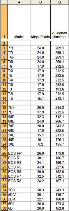

Since you are a birder, the APS-C body would provide you with 'reach' advantage (frame filling). Canon mirrorless are mostly out of your price reach, and most are FF, not APS-C.
A recent post by TeamSpeed does you a favor in some very well priced options for you!
https://photography-on-the.net …showthread.php?​p=19509145
This chart will assist you to see the density of pixels-per-millimeter of sensor, more is better for birders
IMAGE: https://hosting.photobucket.com/images/i63/wiltonw/pixels_on_target.jpg?width=960&height=720&fit=bounds

...unfortunately, for the OP area of photographic interest, even the R5 does not equal a 12 year old Rebel in pixel density! :-(

However if pixel density of a 40D is enough, a 55-250 STM works pretty well from a lightweight and cheap telephoto option for the R series. :)
