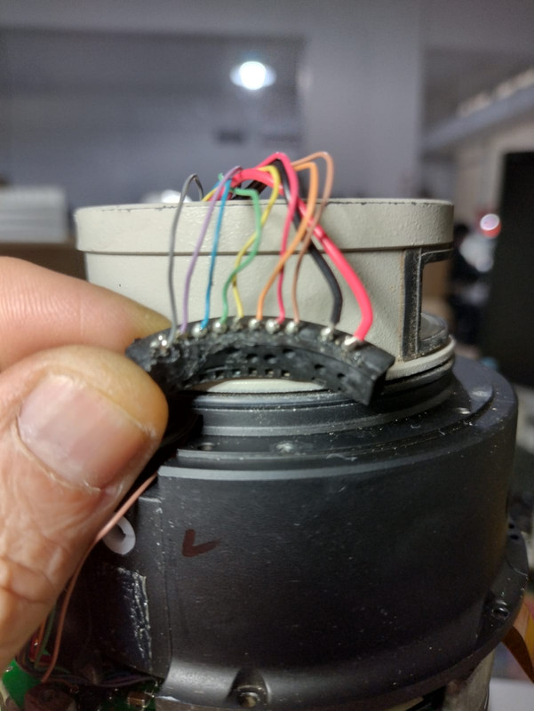

Aug 21, 2023 02:07 |  #3
If you took out the screws and it seemed to have fixed it, the old switches could possibly be failing. Mine stopped working so I took off the four screws on the lens mount and turned out the 7 or 8 wires were so thin, they broke off the contacts and I had to re-solder them. Thankfully back in shape. Almost had a heart attack.

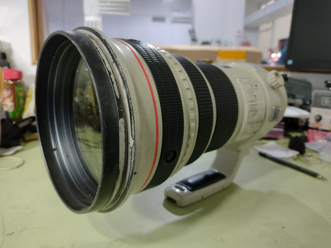

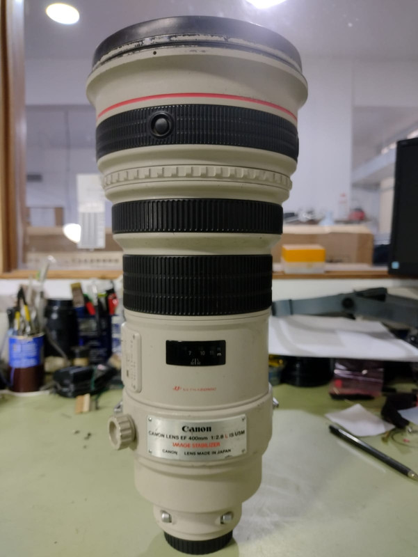

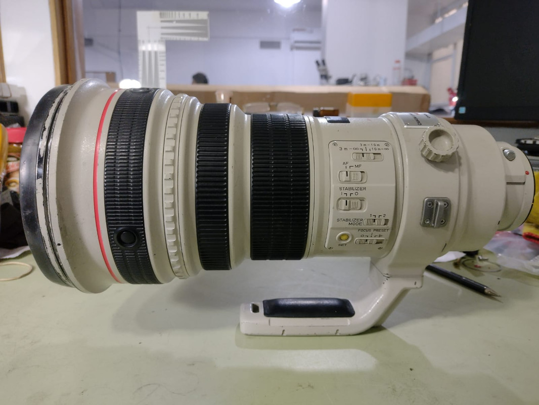

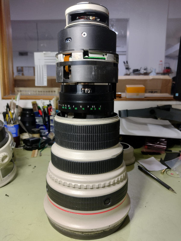

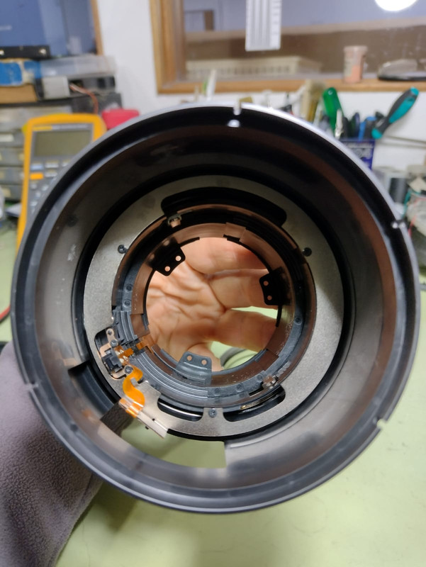

Hi
Finally I took it to an alternative service, because the official services do not take it for its age. These service make adjustments to the focus motor, cleaning and lubrication. He also had to solder some wires. Now it works perfectly, without the need to change parts that are very difficult to find in my country.
Here are some photos taken during the repair process
