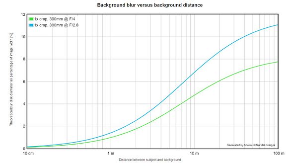

May 09, 2023 18:32 |  #14
paddler4 wrote in post #19516446 (external link)
But I don't believe that you or anyone else could tell the difference between two images shot with similarly designed and equally sharp lenses with different maximum apertures, e.g., the Canon current EF 70-200 f/2.8 L and the current EF 70-200 f/4 L at apertures above f/4.
But one CAN see the difference!
IMAGE: https://hosting.photobucket.com/images/i63/wiltonw/300mm_background_blur.jpg?width=590&height=370&fit=bounds
  1. While DOF at f/2.8 vs f/4 might be so small in shallowness as to be difficult to assess (e.g. 2' vs. 2.8' DOF at 100' shooting distance),
  2. if you compare the two images side by side, the greater degree of out-of-focus blur in the shot at the wider aperture can be differentiated. This graph portrays the quantitative difference...

May 10, 2023 08:18 |  #15
apersson850 wrote in post #19516970 (external link)
Well, then you do believe it, as I wrote it.
However, after having the EF 70-200 mm f/4L IS USM for a while, and then for the first time looking through the viewfinder with my new EF 70-200 mm f/2.8L IS II USM mounted on the camera, I got a wow moment already before taking the picture.
The difference is smaller, of course.
Doesn't your camera stay at maximum aperture until the shutter opens? Of course the view through the viewfinder is different with a wider-aperture lens. What it looks like through the viewfinder isn't the issue. The issue is the image on the sensor.
Check out my photos at http://dkoretz.smugmug​.com (external link)
