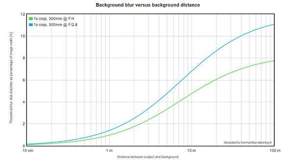

Wilt wrote in post #19517060 (external link)
But one CAN see the difference!
  1. While DOF at f/2.8 vs f/4 might be so small in shallowness as to be difficult to assess (e.g. 2' vs. 2.8' DOF at 100' shooting distance),
  2. if you compare the two images side by side, the greater degree of out-of-focus blur in the shot at the wider aperture can be differentiated. This graph portrays the quantitative difference...
I think we are mixing a couple of issues.
My main point was that unless you intend to shoot at 2.8, you might as well buy an f/4.0 lens and make do with a higher ISO image in those rare instances when one needs the extra light. Yes, the images with f/2.8 and f/4.0 with a bump in ISO would be different, but at apertures >=4.0, they wouldn't be. I'm on my second f/4.o 70-200 and wouldn't consider changing to a f/2.8. One reason is cost. The other is the OP's point: weight. In the case of the new Canon RF 80-200 lenses, the difference is 375g. It was bigger with the EF line, I think.
For the cases where one might shoot at f/2.8, background blur is only one difference. Another is shallower DOF at f/2.8. Speaking personally, I virtually never want shallower DOF than I get at f/4.0 when using a telephoto lens, but that's a matter of personal preference and shooting style.
