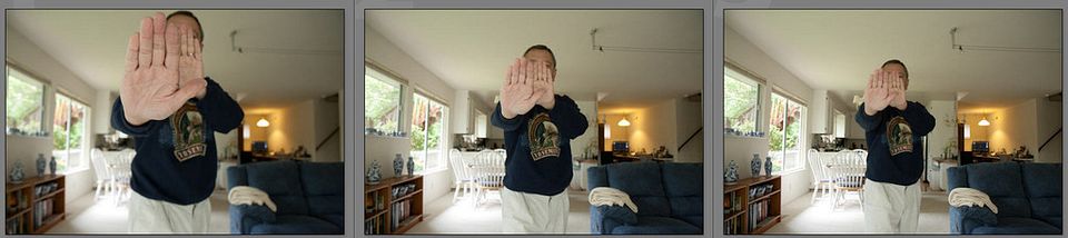

Jul 11, 2023 10:26 |  #6
gonzogolf wrote in post #19538589 (external link)
Ideally you should go with the longest lens that will let you frame the shot you want in the space you have. The farther back you are the less perspective distortion you will have and that can be important as the you don't want the folks in the front row to appear significantly larger than the folks in the back row.
I second this point. When shooting groups, I keep my FL to 28mm at the shortest for 24x35mm frame (or comparable Angle of View for other formats) so as to avoid the issue of a too-close shooting distance exaggerating upper arm size or the prominence of ample bosoms, caused by perspective distortion.
This exemplifies the exaggeration of near things compared to slightly farther things...my right hand vs. left hand. The photos were all taken at a single FL, and only the subject distance varied.
IMAGE: https://hosting.photobucket.com/albums/i63/wiltonw/Principles/whole%20frame_zpstte6h6zj.jpg?width=960&height=720&fit=bounds
