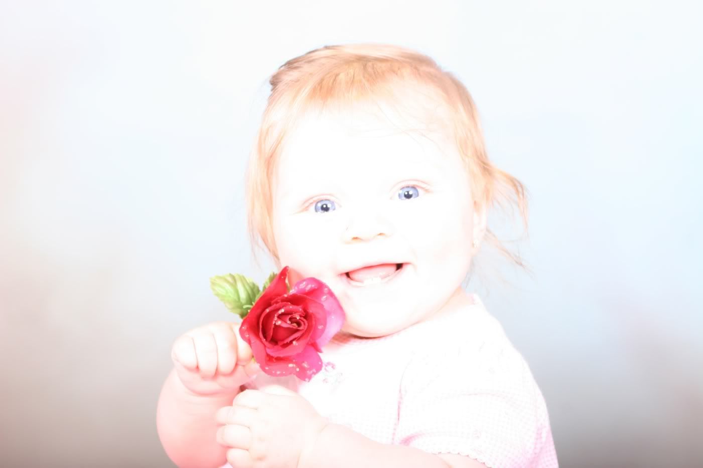

Here is my question. I bought a Canon D2O about 2 months ago, which has worked out great. I set up a little home studio to take portraits of my kids and it went well for a while. Now I'm having HUGE problems with my pics coming out overexposed. I really don't know what I'm doing wrong.
I think it might be something to do with my lense or camera. It is a Zigma Zoom 28-300mm Aspherical IF lense. OK here is the issue: I'm in manual mode. I'm in one spot, say 7 feet in front of my subject, I have taken my light metering and it says to put it on aperture 11. I do this and the shot comes out OK (say I am at 100mm). I focus in a little (200mm) to do a close up shot and it goes COMPLETLY OVEREXPOSED ... I mean not only a little but hugely. I pull the lense all the way back to get a full (say 50 mm) shot and it is still overexposed. But then I put my lense back to the original 100mm and it is fine.
Even if I put my aperture at 32 it still comes out way over exposed if I want to do a close up. The wierd thing is two days later it'll take the close up fine and the full shots are overexposed. It is pretty frustarting.
Like I said before, this all with me staying in one spot and not moving my lights ( one main on the left, one back light on right, and one fill light over my head).
All this has happend the last 3 times I have tried to shoot , but had no problems at all when I first got the camera.
I'm I doing something obviously wrong here? Did I maybe change a setting in the camera by mistake? Could this be something wrong with the camera?
Any light you can shed on this would be a great help. Or maybe have me do clear steps to handle this issue.

May 28, 2006 18:20 |  #2
The Sigma 28-300 isn't a constant-aperture lens (as you zoom, the max. aperture changes from f/3.5 to f/6.3 - about 2 stops), but at f/11, it should be able to maintain your aperture.
Are these pictures in available light, or are you using a flash (and, if so, what flash)?
Can you post a couple of example photos here? One that worked and one that didn't, and include the EXIF dat, which is recorded whenever you take a picture and which most photo-editing and -viewing programs will read?

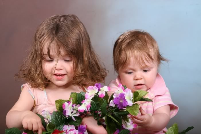

May 28, 2006 18:51 |  #3
IMAGE: http://i41.photobucket.com/albums/e296/Natsbabies/test0022.jpg
IMAGE: http://i41.photobucket.com/albums/e296/Natsbabies/Test0032.jpg
I'm sorry I can't get the data for some reason .I'll try on the Mac.. I'm also going to go and take some more pics since these are not a good expample.
