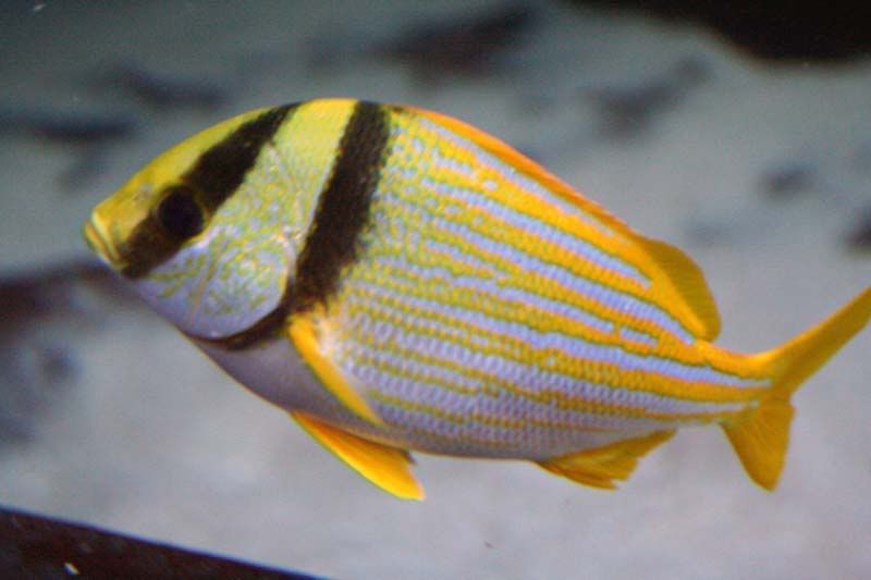

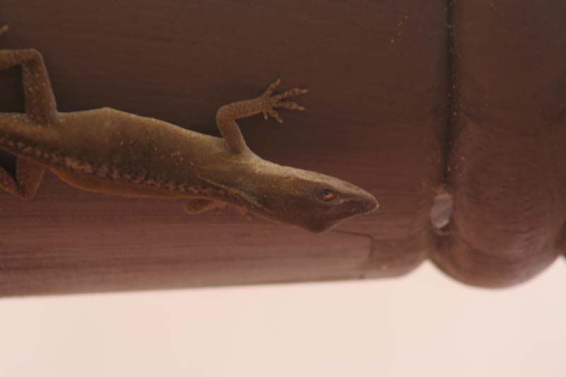

Hi Bob, Thanks for responding. Here are some examples:
IMAGE: http://img.photobucket.com/albums/v500/HBlair/7c8e983a.jpg
Focal Length 300 mm
Exposure Time 1/30 sec
Aperture f/11
ISO Equivalent 100
Exposure Bias
White Balance (-1)
Metering Mode matrix (5)
JPEG Quality (6)
Exposure Program program (1)
IMAGE: http://img.photobucket.com/albums/v500/HBlair/2331f934.jpg
Focal Length 300 mm
Exposure Time 1/15 sec
Aperture f/11
ISO Equivalent 100
Exposure Bias
White Balance (-1)
JPEG Quality (6)
IMAGE: http://img.photobucket.com/albums/v500/HBlair/cc52f641.jpg
Focal Length 85 mm
Exposure Time 1/40 sec
Aperture f/5
ISO Equivalent 400
Exposure Bias
White Balance (-1)
JPEG Quality (6)
Focal Length 50 mm
Aperture f/2.5
ISO Equivalent 800
Exposure Bias -2/3
White Balance (-1)
JPEG Quality (6)
Exposure Program aperture priority (3)
IMAGE: http://img.photobucket.com/albums/v500/HBlair/b2d4b3bc.jpg
Focal Length 50 mm
Exposure Time 1/100 sec
Aperture f/2.5
ISO Equivalent 800
Exposure Bias
White Balance (-1)
JPEG Quality (6)
The first three were manual focus using the tone. the last two were auto focus. I know it's probably something I'm doing but any advice would be a great help. (The monkey I actually like it just not sharp.......it's very soft)

The first shot is front-focused, probably the AF system focused on the grass in front of the bird because there are more areas of sharp contrast there than on the bird itself. The AF sensor is actually larger than the box in the viewfinder, and it looks for contrast.
The shot of the monkey seems about right, though I would need to see the original image to tell for sure. The DOF is pretty shallow in this shot. The eyes appear to be focused but the nose is not.
As for the lizard and the fish, keep in mind that the depth-of-field is extremely shallow in close-up shots. The slightest movement (of either subject or camera) between the moment you lock focus and the moment you take the shot will throw the focus off. Fish shots are incredibly difficult for this reason.
Slow shutter speed likely contributed to a lack of sharpness in the first two images. I'm still trying to figure out how you got that close to the lizard with the 75-300 lens.

The shutter speed seems very low for these shots.
A good guide for shutter speed is shoot at a speed equal or faster than your focal length. So for your bird shot it should have been 1/300th or higher. Of course if its on a tripod it then depends on how fast your subject is moving but I think a similar speed would be need.
Also I would suggest using center spot AF if you don't have it selected already.
Test your lenses for front/back focus problems. A quick search will reveal plent of info how to do this.
