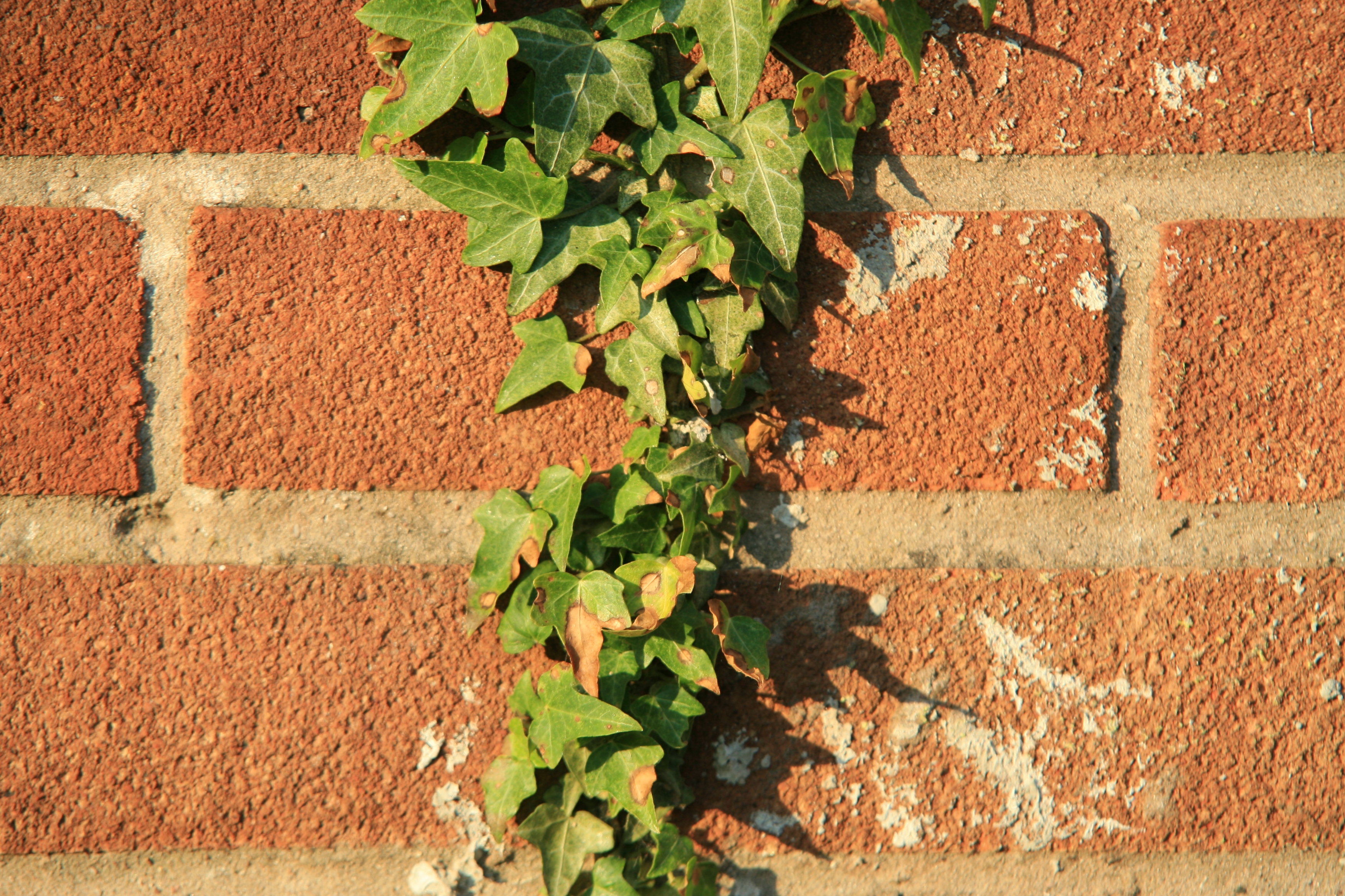

Bit of dead ivey (f11 @ 1/40th second). Pretty awful, especially towards the bottom of the shot.
http://www.alfa-pages.co.uk/temppictur​e/focus3_large.jpg (external link)

An example with a higher shutter speed.
This is taken at ISO 100, 200th second shutter speed and f5.6.
http://www.alfa-pages.co.uk/TempPictur​e/Focus6_large.jpg (external link)
The leaves closest to the camera are noticeably sharper, those farthest away (about an inch max) blurred. At f5.6 the depth of field should cover that.

I agree with others - get that shutter speed up a bit. Although you used a tripod, you can still get some vibration from the reflex mirror as well as subject movement with a slow shutter.
The last shot you took shows some pretty crisp leaves on the ivy you shot, at least in the center/top of the frame. Is the bottom of the image farther from the camera? If so, it could be a depth-of-field issue. The closer the subject, the more shallow the DOF appears.

Distance is about the same (top and bottom).

#1. I USM'ed your last one and it shapened right up.........another 170, 0.3, 00
