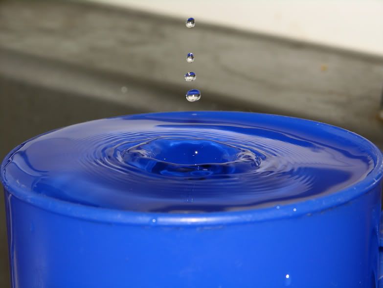

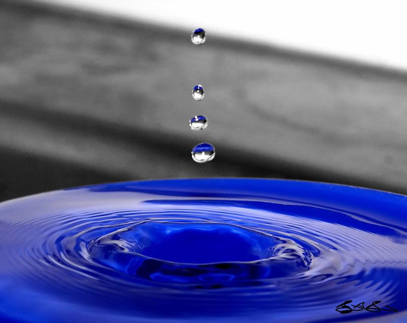

A slightly different alternative...
Check out your flashes durations at certain power levels... the Metz 58-af1 I used for these has duration of 1/33000 second at 1/256th power (gn of about 1 :) )
So, using the off camera shoe cord I put the flash very close to the bowl and triggered the camera (set to 1/250th) from the pocketwizard... you can watch drops falling and trigger pretty accurately...
www.trolards.com (external link)
