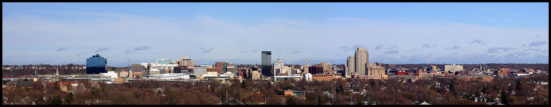

Hey strok, here's a 4 picture pano (hand held) I took of my city back in the spring using my 50 1.4.
http://i2.photobucket.​com …%20Cityscapes/G​Rpano1.jpg (external link)
f5.6 (probably should have gone down to f8 )
ss: 200

Oct 13, 2006 09:50 |  #10
I shot mine horizontally because I was about a mile away from the city. If I were closer, or using a bigger lens, I might have done vertical.
