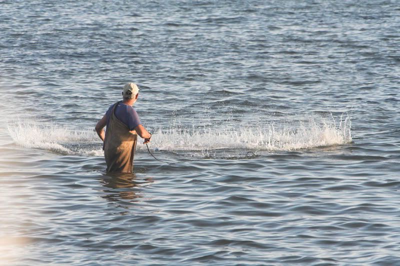

I was under the impression that this lens (70-200 2.8IS) was pretty resistent to flare. However, I have gotten what looks like some form of flare, even though its not the more common one I usually see.
This one was with the Hoya Pro Digital CP, I don't remember if I had the hood on.
(bottom left)
IMAGE: http://i82.photobucket.com/albums/j250/heatseeker99/69171439.jpg
And this one without a CP and hood was on.
(right side, top to bottom)
What do you think?

Something like that used to be 'fogged film' caused by accidentally opening the camera back before winding the film back into the cassette! If that was shot with the Hoya Digital, it makes me wonder what it would look like without the blackened filter edges!

The picture of the man netting for bait was with the CP. #1

Still cannot see the second picture! My original comments were about what I was seeing in image #1. What a minute, I right clicked the icon for the second picture, the menu showed an entry to show the image, and I clicked it and it appeared! Weird.
Flare in both pictures, no polarizer for the second one, so cannot lay blame on a filter. Flare in the lens is the only remaining suspect!

It doesn't look like flare to me, but rather out of focus foreground objects intruding into the field of view.

I agree with mark, it just OOF foreground to me.

I just cannot imagine something translucent and out of focus being in the frame in shot #2, although that is certainly what it looks like!

I second that diagnosis, certainly for the second picture and probably for the first. The second looks like it's taken through a wire fence or something similar (plus nearby leaves).

There is no way the first one is OOF. It was taken at f/5.6 and from a distance. How can the water on the left be OOF and the rest not?
Now granted the second was shot at f/2.8 and the vegetation in the foreground is OOF, BUT run your eyes over the brown tree branch and you can see haze in one area that is in the same focal plane.

I third it x2 looks like there was a leaf or something like that really close

Yep, ok I am seeing that now. And I bet that is it too b/c there were leaves there. Thanks
#1 still remains a mystery. It was the last of a 4 shot burst and all the rest came out great.

both cases definitly look like a closr object out of focus, they also look nothing like flare, which is typically vewry linear, and accompanied by cicrular rings of various green to red colors.

its not the water thats out of focus, its another object that snuck into the corner of the frame thats out of focus.

And look at the pinkish/reddish thing at the right side of shot #2...the reddish thing has much better edge definition than a simple out-of-focus object!
