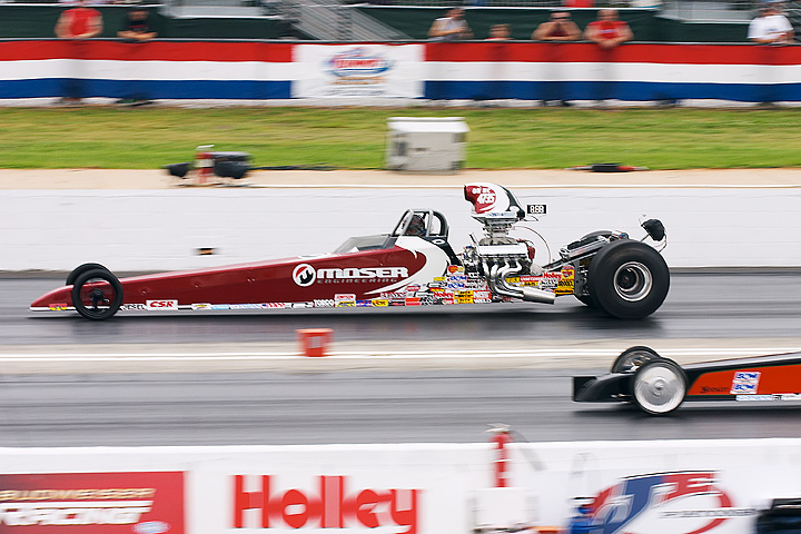

I don't have any experience shooting motercycles. Are the bikes moving? If so, are they coming towards you or are they traveling across the frame? I've seen some amazing bike shots taken by folks who have mastered the art of panning the camera with the bikes as they speed by. Generally in this case, they don't use a very fast shutter speed. Something around 1/200s or so seems to work well.
Here's a (very fast) car that I photographed with a Digital Rebel/300D at 1/250s:
IMAGE: http://dsnyder.ws-e.com/photos/potn/drag_racing_0025.jpg
It's pretty rare that folks have AF problems with the 20D (and higher) cameras. Perhaps you can borrow a friend's 20D/30D/5D for your next shoot to see if you can reproduce the problem. If the problem does not go away with a different body, the source most likely lies elsewhere. :rolleyes:
