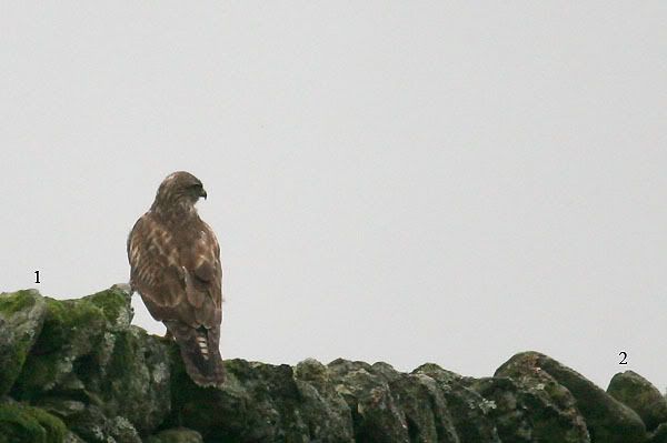

This test was done between a 5D and a 20D with a 100-400L at full stretch, users of a 1DSII will find much less of a difference, because that camera has a higher pixel density than the 5D.
Yes, the image is crap - I was shooting in very dull conditions, waiting for the rain to stop, I was far too far away from the buzzard to get a decent shot but I thought it would be a good test of reach, when trying to shoot birds a bit less far away.
These images are very heavily cropped and have been reduced in size (identically) a little for posting, All the original production was done on (and the final measurement is based on) the originals at 100%.
I didn't use the actual buzzard for the measurements because he is more upright in one pic than the other, I therefore measured between two easily measured points on the rock wall - the small peak at position 1 and the notch at position 2 (20D) / 3 (5D).
First up, the image from the 20D:
IMAGE: http://i24.photobucket.com/albums/c19/sandpiperphotos/cropcomparison20D.jpg
Now the image from the 5D:
IMAGE: http://i24.photobucket.com/albums/c19/sandpiperphotos/cropcomparison5D.jpg

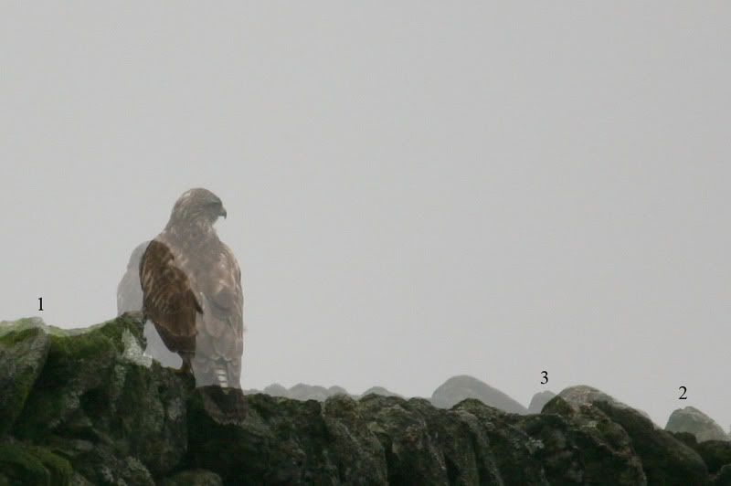

Finally, the 5D superimposed over the 20D:
IMAGE: http://i24.photobucket.com/albums/c19/sandpiperphotos/cropcomparisonboth.jpg
As you can see, the 20D image is significantly larger than the 5D, although not as great as some might think.
In pixel terms the distance between points 1 and 2 (the 20D shot) is 1011, the distance between points 1 and 3 (the 5D shot) is 791. In linear terms the 20D result is about 26.6% longer than the 5D image. More to the point, that appears to have resulted in a better image due to the extra pixels, although it should be noted that I haven't done much to these in post processing. Remember these figures were measured on the original 100% crops.
So, it does seem that the 1.6x crop factor cameras have a significant advantage when the subject requires heavy cropping. In this case of course the cropping needed would be too heavy (even at his full height, on the 20D image at 100%, the buzzard is only around 380 pixels tall) but the image serves to compare the two formats.
