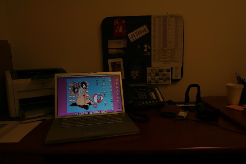

Hey everyone, I am having some sort of problem here and I don't know what is going on. I am using a Canon 350d (digital Rebel Xt) and a Speedlite 430ex Extended Flash. This problem just started on Saturday. When I use my extended flash, or even my on board flash the photos come out very very dark, as if I used no flash at all. I have tried shooting in all different modes, turning up the flash compensation etc. I reset all of the settings on the body and the flash so I dont think it could be an issure with that. I leave for Europe in two weeks and I can't have my camera acting like this! Here are some examples, including exif data.

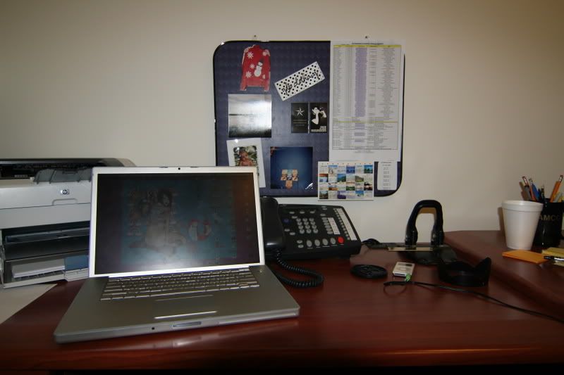

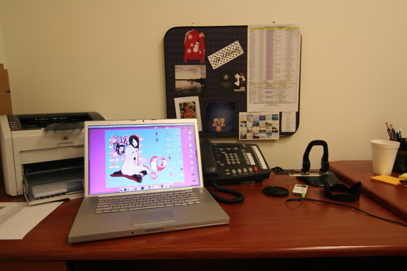

Ok, I took three pictures... one with the extended flash, one with the on board, and one with no flash at all. Here they are:
IMAGE: http://i6.photobucket.com/albums/y249/SublimeEp/430ex.jpg

IMAGE: http://i6.photobucket.com/albums/y249/SublimeEp/OnBoardFlash.jpg
On Board Flash (Exif Data: http://www.flickr.com/​photo_exif.gne?id=3213​40247 (external link))
IMAGE: http://i6.photobucket.com/albums/y249/SublimeEp/NoFlash.jpg
No Flash (Exif Data: http://www.flickr.com/​photo_exif.gne?id=3213​40240 (external link))

Dec 13, 2006 09:33 |  #2
Have you set the flash exposure compensation on the 430EX to a ' - ' setting by accident? It looks terribly underexposed.

Dec 14, 2006 06:52 |  #7
Sublimejoe wrote in post #2394111 (external link)
I don't think that's quite right. The photo you've posted that was taken with the onboard flash (#2 of 3) looks as I'd expect.
The camera has taken the shutter speed down from 1/3th (no flash) to 1/60th (flash) and used the on-board flash as a fill-in. The corners of the picture are dark because the flash doesn't cover them as effectively as the centre, and the overall exposure may be a bit dark because the metering has been confused by the bright reflections from the computer and the glossy picture on the noticeboard.
So not a perfect picture, but about what I'd expect from the onboard flash given the conditions.
The problem seems to be confined to your 430ex. It doesn't seem to have fired at all. can you confirm that it did not in fact fire? Can you do anything to make it fire?

Dec 14, 2006 07:38 |  #8
StewartR wrote in post #2398579 (external link)
As you will notice in my Exif data, the extended flash did in fact fire. I just took the pictures in my office as an example, I have been experiencing the same problems in any setting that I use my camera in.
I used my 430ex on a friends 20d and it works perfect. The problem seems to be leaning more towards an issue with the body rather than the flash. :/

Dec 14, 2006 07:49 |  #9
Sublimejoe wrote in post #2398689 (external link)
Yes, I knoe the EXIF data says the flash fired, but the picture looks like it didn't. I can conceive of faults where the camera thinks the flash has fired, but the flash hasn't actually fired. Hence the question.
So what does actually happen? Try taking a couple of photos, using the onboard flash and the 430ex, but with your eye away from the viewfinder so that you can see how much light they each put out. Are they comparable?

Dec 14, 2006 08:18 |  #10
StewartR wrote in post #2398725 (external link)
I was wondering that yesterday too actually. When I took those pictures I was shooting from the hip so I could see that the flash is going off. THe 430 is just as bright as ever, ive used it to blind a few people in my office over the last few days. Same goes for the onboard, same as its always been. I tried changing the settings between 1st and 2nd shutter sync but there isnt a noticible difference.
I have posted it up for sale as is on the classifieds. It is under warranty so if someone buys it they have a couple options. They could either use it the way it is or send it into canon and get it fixed for free.
