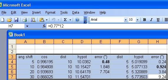

Thanks, Mark. I read the explanation and at first blush it makes sense. However, upon addition thought, the argument seems to start to fail...
First of all, the assumption is that all lenses are flat field lenses, which is not true. Macro lenses are most often flat field corrected, but other lenses are not necessarily. Some lenses like the Tamron 17-50 exhibit considerable curvature of field (photozone.de test report).
Secondly, the math is not quite right on the web example. If we first assume the eye-to-mid chest distance is 12" (it is on me) a angular shift is just over 5 degrees when you recompose at a shooting distance of 10' and it is 11 degrees when you recompose at a shooting distance of 5'. Now if we plug those numbers into a spreadsheet...
IMAGE: http://i69.photobucket.com/albums/i63/wiltonw/focusshift.jpg
we can see the error is 1/2" at shooting distance of 10' and scarcely an inch when shooting at 5' ! Shooting at 10', you need to have an angular camera angle change of 20 degrees to exceed DOF on a wide open lens. So in theory it matters, but in practice...I'm still skeptical. I could be wrong on the Excel spreadsheet calculations!

Alfred, I agree in principle, but the analysis (message #3) does not support the principle -- unless the angular movement of the camera is sufficient to cause a significant enough shift of the plane of focus vs. the primary plane of interest.
0.5 to 1.0 " error (resulting from 5-10 degrees of shift) hardly seems a large enough shift, if we use the web site article that had been quoted, as the argument for why the practice of focus-recompose-shoot should not be followed. Care to comment?

But that is not my issue in question. My issue is that a web article depicted a portrait situation, focusing on the eyes then shifting center of frame to midchest, a distance of only 12" and an angular distance of 5-10 degrees, depending upon shooting distance. And THAT situation is the one that I am disputing the validity of the web article!
