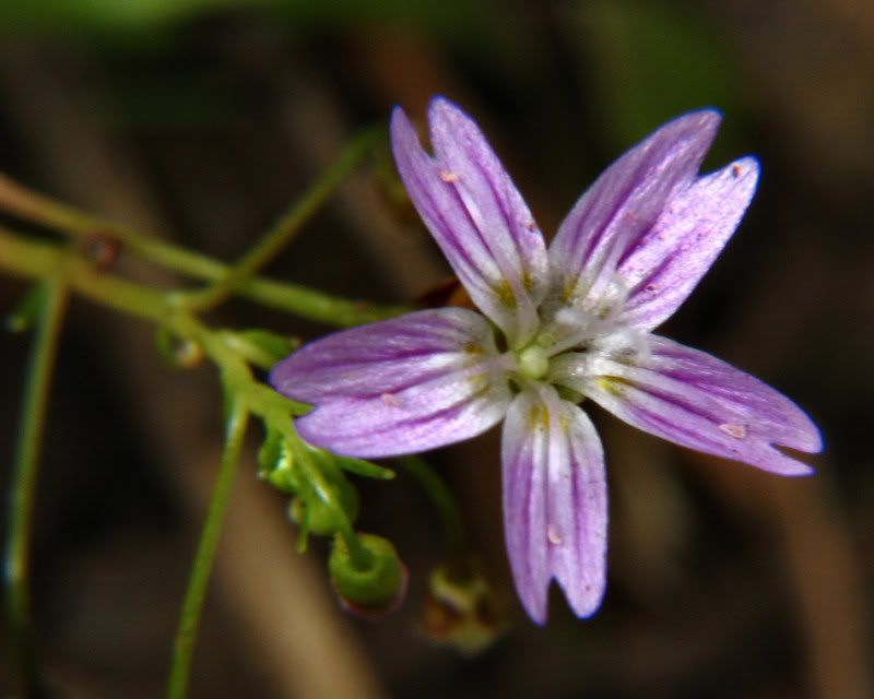

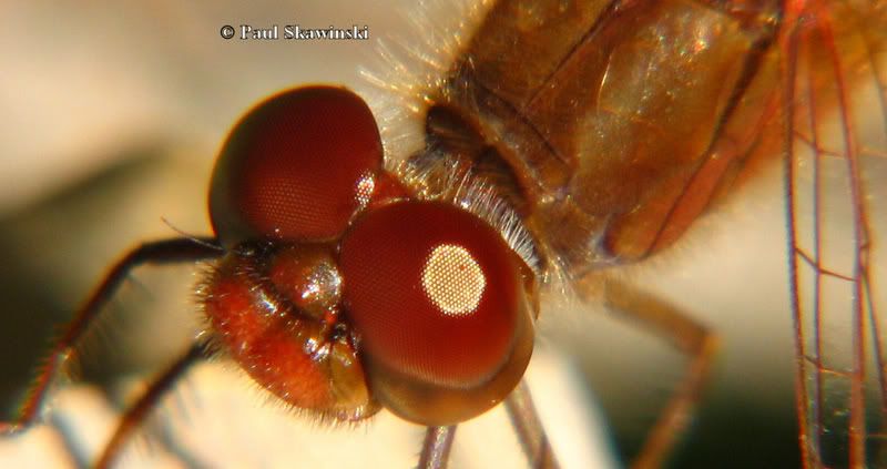

They may be cheap, but I have been quite happy with them. Here are a few examples:
+4 filter:
IMAGE: http://img.photobucket.com/albums/v627/White95Max/Flower-R.jpg
+4:
IMAGE: http://img.photobucket.com/albums/v627/White95Max/Snake5-EC2.jpg
+10:
IMAGE: http://img.photobucket.com/albums/v627/White95Max/Dragon3-CR.jpg
Considering that I got all 4 macro filter for just over $100, I can't complain.

Those Hoya c/u shot are ok, but I wouldn't say they are competition standard. It all depends on what you find acceptable.
Look at this example, taken with the 500D. You'll notice that the butterfly's antenna to the left, the wingtip to the right and the leaf all the way along the bottom are all sharp with none of the chromatic aberration in the above shots.

Can you specify and point out exactly what are the chromatic aberrations in the photos?
The flower shot has blue fringes around the petals and it's generally soft. The snake shot is pretty good, probably because there's no sharp definition away from the centre where any lens should do ok, although there's a tiny bit of blue fringing around its nose. The left eye on the dragonfly has quite bad red fringing and there's distortion everywhere away from the centre. This is such a shame as it's obvious a fair amount of talent and effort has gone into taking the shot. In my opinion this lens in particular wastes the quality of the S3 optics, and if you really want to shoot anywhere near +10 dioptre you should look at the Raynox DCR-250 which is +8. Believe me, you'll be struggling with this sort of magnification because of the narrow depth of field, but optically it is pretty good.
@2Shiny, this is not hammering your efforts, which are commendable, but I do feel your talents would shine better with better kit. And I do like that snake!

Feb 01, 2007 18:24 |  #15
Any criticism of my pics is always taken constructively. No hard feelings.
