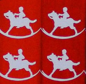

1.4 100% crop:
IMAGE: http://i237.photobucket.com/albums/ff195/sunking39/14.jpg
1.6 100% crop
IMAGE: http://i237.photobucket.com/albums/ff195/sunking39/16.jpg
1.AV, 1/400 stop, iso 1600, sharpness 4
2.1/320 the rest is the same.
What do you think?

That's pretty bad. Have you tried micro adjusting... I tried this out real quick today and at +10 it seemed to be back to normal however at my shoot on the weekend, I was getting ugly results at 1.4
Today seemed good, but maybe he was too close (I snapped this as I was leaving work so I didn't have much time)
100%
