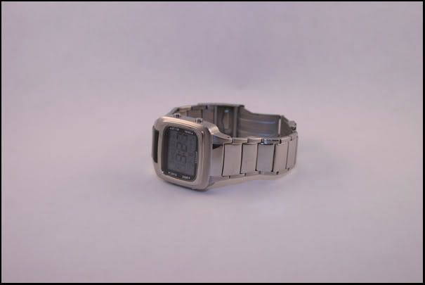

Baldingo540
79 posts
Mar 06, 2008 17:38 |  #1849
i spray painted the sides and top white, switched the WB to Tungsten, this is what i got
IMAGE: http://i102.photobucket.com/albums/m102/Baldingo540/watch4.jpg
1/60
F4.5
two 500 watt utility lights through the paper sides and a 420ex aimed straight on

Mar 06, 2008 17:44 |  #1850
Baldingo540 wrote in post #5062571 (external link)
1/60
F4.5
Did you see my post above?

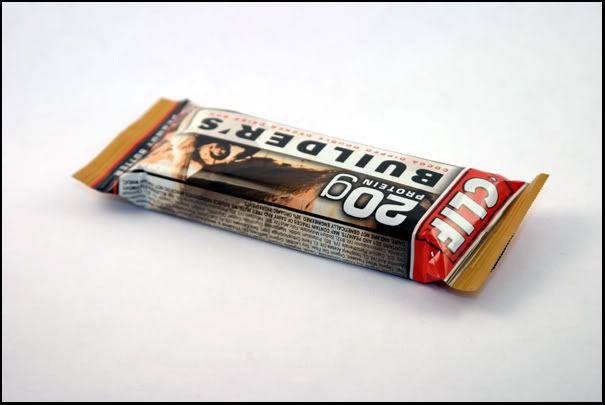

Mar 06, 2008 17:58 |  #1851
after a little more experimenting (and helpful advice) i got this
IMAGE: http://i102.photobucket.com/albums/m102/Baldingo540/Clif.jpg

Mar 06, 2008 18:16 as a reply to  @ Baldingo540's post |  #1852
Much better. :mrgreen:

Mar 06, 2008 18:17 |  #1853
Much better, but you still should get that aperture down to f/11-f/14. This still has a pretty narrow DOF.
The exposure looks much better though. Maybe to to bump it up a bit more, but that is pretty close.

Baldingo540
79 posts
Mar 06, 2008 18:17 |  #1854
IMAGE: http://i102.photobucket.com/albums/m102/Baldingo540/clif2.jpg

Mar 06, 2008 18:20 |  #1855
Baldingo540 wrote in post #5062791 (external link)
1/10
F/11
Nice, now try with a shutter speed around 1/5 - 1/4.

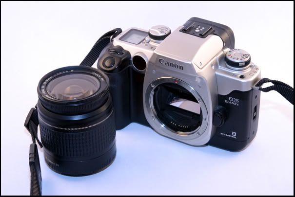

Baldingo540
79 posts
Mar 06, 2008 19:26 |  #1856
IMAGE: http://i102.photobucket.com/albums/m102/Baldingo540/ElanLens.jpg
