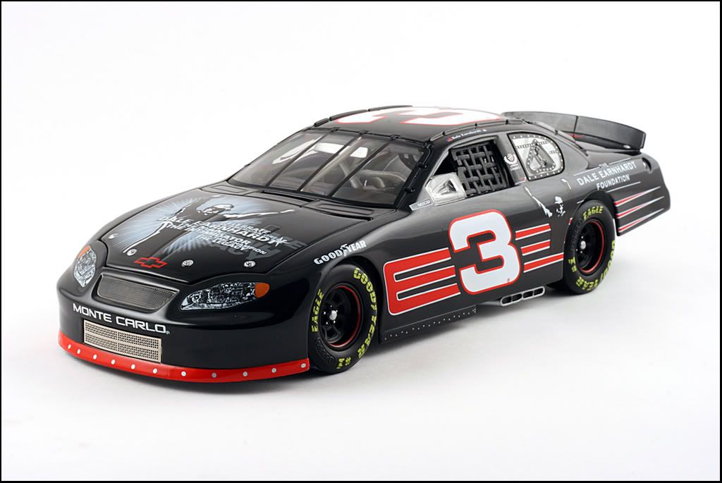

Gizmo1985 wrote in post #6988485 (external link)
This is a good example of when you need some black paper to reflect in the sublect. The light will be fine still. But the black paper will keep the black parts of the car black.

Mark1 wrote in post #6989117 (external link)
ok ill try it out with my black background
