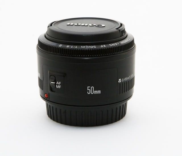

If you don't feel like it then I wrote a short run down
I think your trying to mix product photography with portrait photography. I say this because it seems like your shooting a product, but still keeping the background all wavy and stuff like you would with a portrait?
Try to get the background as smooth and flat as possible with no angles what so ever. Id suggest even ironing all of the wrinkles out. The trick is the smooth backdrop with no angles-- nothing that can create a shadow.
Once you get your backdrop smooth, take a close up picture of the backdrop with all of your lights on and set your custom white balance to this image (shoot in raw if possible. Makes blowing out the background much easier). Use f/8-11 for your shots and try to throw as much light into that box as humanly possible. Instead of cloth as your backdrop, use paper (I use poster board because its much thicker) and use your cloth for now as your light diffuser (Id use something thinner than that when you can get a chance because that thick cloth will kill a lot of the light. I use a very thin white cloth, almost transparent). Pick up a few flood lights for about 10 bucks a piece and place them on each side. Oh, and don't forget to use a tripod.
This is my setup. I also use my hotshoe flash with omnibounce pointed at the roof of the box at about 1/4 power.

hmm i see. i just have to get some paper.
i dont think i can control flash output with my 420ex.
also dont think i can get that close with my airplanes. these things arent that small!

Dont need to get close, just have to get bigger paper! lol. Really though, 20 bucks for a couple flood lights will work wonders on getting that nice background you want.
Just make sure you use a tripod and get good DOF.
