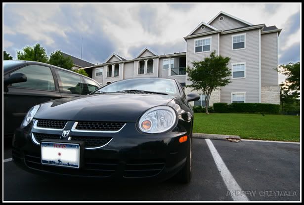

What I do when not using HDR photomatix, if just using PS, I just put the shot the blown out BG on top, and use the select by colorange, and click on th ehot spots, then delete. This doesn't look really good though. If you shot these in raw, you can easily under and overexpose them and toos them into that program and PRESTO!
Here is an exaple of the first way, as you can see, it's not too hot.
IMAGE: http://i23.photobucket.com/albums/b386/atgrzymala/Sigma%2012-24/IMG_1480e.jpg
BTW BEAUTIFUL car, it has plates too, someone actually takes that on the road! AWESOME!
