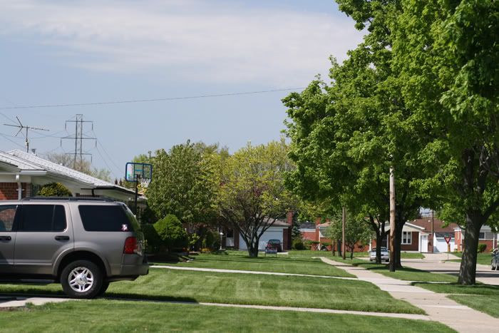

OK....here is with polarizer
IMAGE: http://img.photobucket.com/albums/v340/marydoright/Learning%20Pictures/withpolarizer.jpg
and without
IMAGE: http://img.photobucket.com/albums/v340/marydoright/Learning%20Pictures/withoutpolarizer.jpg
i dont know, maybe its just me, but when i have it on the lens and rotate, its just REALLY hard for me to tell any difference.......maybe Im not using it right?:oops:

CPL's aren't exactly made for that. They're made to get rid of reflections off shiny surfaces, and due to their coating they make greens greener and blues bluer. If they're already vivid, I wouldn't expect much of a difference.

Right away, I see flare. This indicates that you will not see much polarizer effect. You are simply too close to the sun for them to work at maximum.
I look back and see I was a bit misleading. You need to be between 45 and 180 degrees for it to work best.

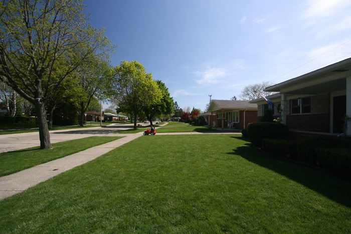

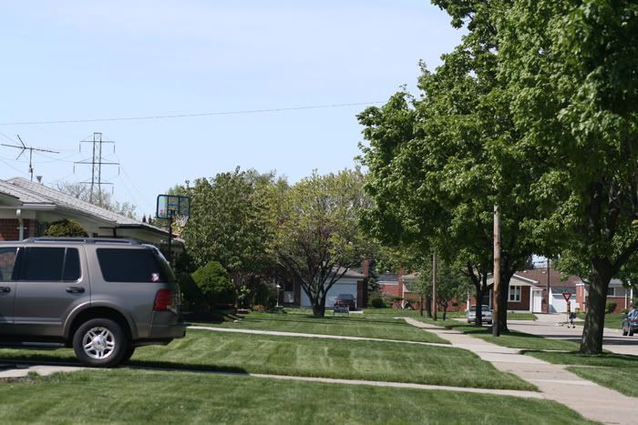

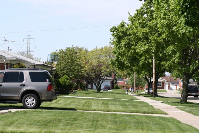

now, heres my cheapo Hoya
i can tell the difference right off the bat while using my view finder as i rotate it
with polarizer on darkest

polarizer on lightest

no, when I use the Hoya, i have no problems at all telling the difference as I rotate it...especially on shiny surfaces.....but the much more expensive B+W, I am! Maybe the B+W is just too dark all around for my eye balls to tell the difference?

well, i have a hood, but to rotate the polarizer, i have to take it off :( Im NOT good at angles LOL at all! The sun was to the right of me up over behind the house. Its 4pm east coast, so the sun is starting to work its way down......behind the houses......maybe Im using it in TOO much sun to get an effect? could that be my problem?
on the Hoya pics, the sun was on my left.....i aimed down the other side of the street since my neighbor parked in the drive way next store and blocked my testing view LMAO

yeah, with the hoya, ur also facing a completely different direction than the one with the b+w filter.

would that matter? the sun is still to my side, either way? let me take test shots in the same direction then with the B+W as i did the Hoya, just incase!

May 07, 2007 15:16 |  #13
Mary, slow down.
You're testing for no good reason really. But if you need peace of mind do this.
Get out your tripod. Lok directly at the sun and stick you left arm out and point. See what you are pointing at. That will be the far right limit in your frame.
Mount camera on tripod. Test with both polarizers. Trun and back off, turn again and back off. Make sure you have them dead on at the darkest. Then take two pics with each lens/polarizer combo.
Now, really key to this is to shoot in M. Keep the settings between the two tests even.

May 07, 2007 15:27 |  #14
ahhhhhhhhhhh OK! so I MUST be using it all wrong then.....not at the correct angle from the sun!
