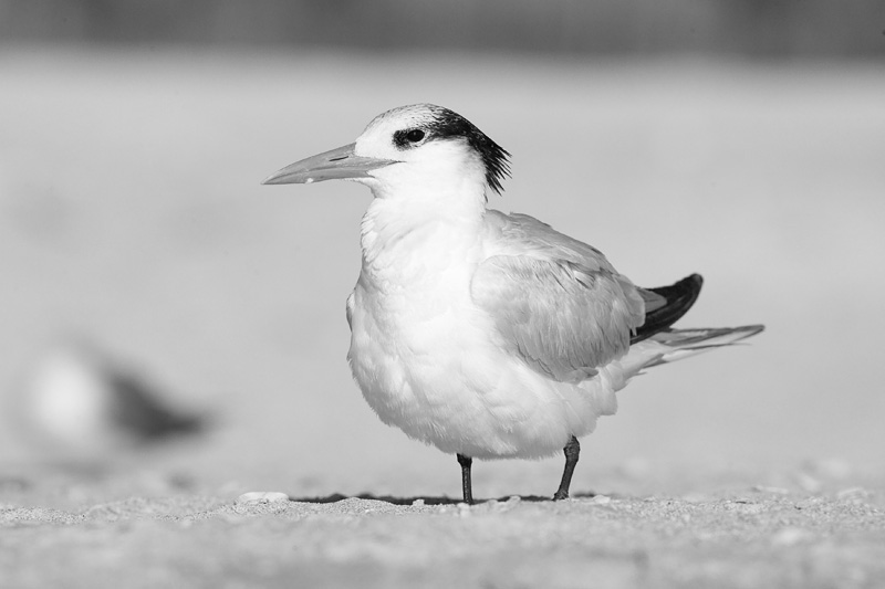

Now here is a example pic with it's B&W counterpart
IMAGE: http://www.allensvisions.com/pics/VIS_0058w.jpg
And here is what the meter sees in B&W
IMAGE: http://www.allensvisions.com/pics/VIS_0058bw.jpg
^As you can see in the photos above the photo 'averages' to lighter than the 18% gray so the camera tries to darken it (underexpose). So in this case for a situation where the photo is lighter than 18% gray you need to add EC to expose this properly. In these cases EC of +2/3 to + 2 are in order. In this example +1 was used although the correct EC was + 2/3 probably because of that dark stripe on top.

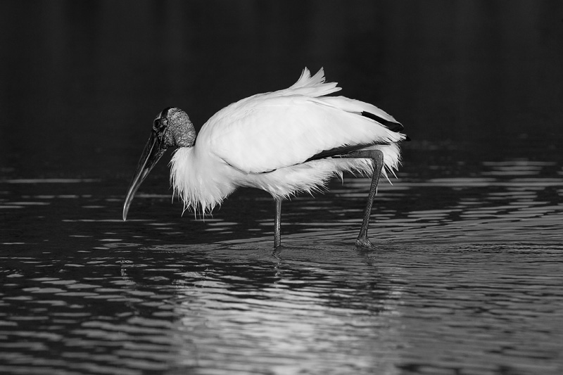

IMAGE: http://www.allensvisions.com/pics/VIS_0304w.jpg
IMAGE: http://www.allensvisions.com/pics/VIS_0304bw.jpg
^OK in this example we see the photo is much darker and averages to darker than 18% gray. Not setting EC here will cause the camera to overexpose the photo and burn the whites on the Stork. So in this case mainly when part of your subject has white on it you will need to adjust EC negative. The darker the photo average the more negative you need to go. -1/3 to -1 1/3 usually get it. In the example above -2/3 was the ticket.

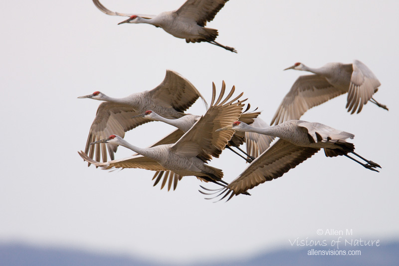

IMAGE: http://www.allensvisions.com/pics/SF5B5932w.jpg
IMAGE: http://www.allensvisions.com/pics/SF5B5932bw.jpg
^Here is a common Bird in Flight Setting against a very light gray sky. In this case as in in case #1 above the meter will underexpose. Generally for birds in flight against a bright sky I set EC to #1 and adjust from there. In this case + 2/3 worked well mainly because the large group of birds darkened the average. If it was only 1 bird in this frame + 1 1/3 may have been better.
