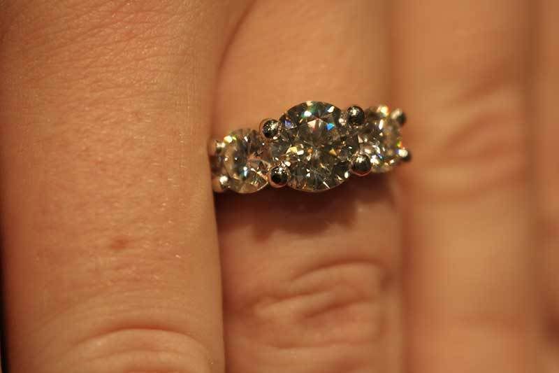

I find that I can focus to about 8 or 9 inches from the front of my 70-300 DO with the 500D close up lens. Not quite 1 to 1 but it is close. This is a photo of a ring I assembled take with a 70-300 mm DO and a 500D close up lens.
IMAGE: http://i120.photobucket.com/albums/o165/wmschenk/IMG_0259_web_copy.jpg
Incidentily the meta data tells me that this was taken at 185 mm.
