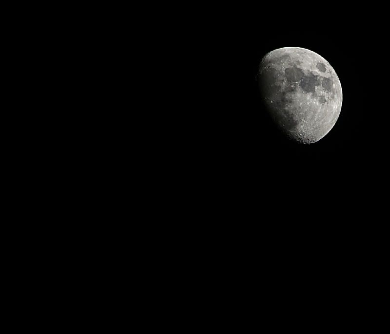

Tonight was a crystal clear night, noticed while i smoked a quick one that the moon was very bright in the sky. Decided to get out the tripod,camera and sigma 70-200 w/2x attached. Set everything up, played with the settings till i found one that i liked and shot away. I made sure the lens was at 200mm to get a good tight close up.

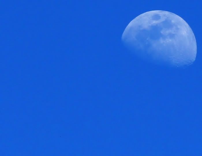

When i uploaded the pics i was a lil disappointed. The halfmoon tonight seemed like it could've been alot closes with the 2x attached to the 70-200.
Moon taken tonight w/2x (external link)
Taken 3/27 handheld with no 2x (external link)
No i pretty much no nothing about astronomy, but does the moon get closes and farther away during its trips around earth? If so then this would explain why one is closes then the other. How can i find out when the moon is the closest it gets to earth?
Oh and both pics are 100%crops.

The Moon does vary in its distance to the earth at various times. But not enough to make it bigger or smaller to us. The reason it looks bigger closer to the horizion is an optical illusion. Hold a quarter at arms length when the moon is high in the sky (appears smaller) it will cover the Moon, now do it again when its on the horizion (appears bigger) it will again cover the moon. Did the quarter get bigger? I don't think so. :)

The change in the appearance of the moon during a month is illustrated very well by the amazing animation on the Wikipedia page about libration (external link). You can see that, in addition to 'wobbling' on its axis, the moon does approach and recede a little because its orbit is not perfectly circular. The extreme change is around 10%, and therefore it looks up to 10% bigger at some times than at others. That's enough to be noticeable in a camera or telescope, but probably not to the untrained naked eye.
If you're using a 350D/XT, the moon should take up roughly 1/8th of the short side of the frame with a 200mm lens and about 1/4 of the short side of the frame with a 400mm lens. Your 200mm shot is compatible with this but the 400mm shot isn't.
So, how is this possible? Simple. The shot you took recently is not a 100% crop.

Bot shots are 100% crops of hte original shot. The second shot, the handheld one, was taken around 330pm i think.

100% view is 100% view no matter what crops you did to the frame..compare the size of the moon only.. the size and ratio of the frame dont matter, if both are infact 100% views

Are you sure both are 100%? The day shot looks less sharp than the night shot, almost as if it has been cropped greater than 100% (like 120% or so). Of course this could be due to conditions when the shot was taken.
Do you have the original raw files for both?

Anyway, in the first picture (May 27th, black sky, 400mm lens) the diameter of the moon is about 200 pixels. In the second picture (March 27th, blue sky, 200mm lens) the diameter of the moon is about 280 pixels, which is 40% bigger. I really do not see how that is possible if they really are both 100% crops taken with the lenses that are claimed.
It would help if you could show the original (uncropped) frames.
