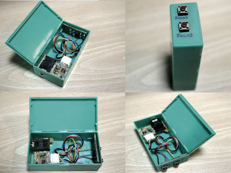

if you fancy a bit of DIY you can make a cable remote. I just finished making one and it cost me nothing - I got all the parts from an old stereo and the cable from a set of headphones.
IMAGE: http://www.arumdevil.com/stuff/pics/remote.jpg
the box is a bike puncture repair kit and it connects to the camera with a cable that has 3.5mm jack on one end and 2.5mm on the other (both stereo). I haven't got a toggle switch in there yet. (good for bulb exposures)
for instructions on how do make it see this page (external link). This one was for the Canon EOS Elan IIE / EOS 50E but it works for the 300D too.

Great ideas! I think I'll build myself a switch.
Thanx for the links! - Da Roach
