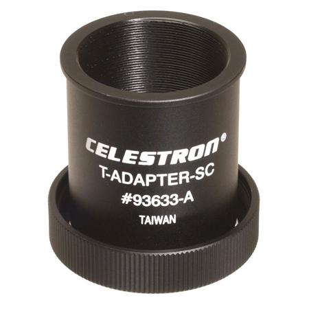

I "THINK" you'd just need the Celestron SLR T-adapter & an EOS T-Mount Ring.
Celestron SLR T-Adapter Schmidt-Cassegrain Telescopes Part# 93633-A (~$35)
Kowa T-Mount (T-Adapter Ring) EOS part# TSPK-CE (~$23) (Celestron's is about $14).
I read on one of the forums that the Kowa T-Mount is the compatible with all the Celestron stuff (please verify this). I have just the Kowa T-Mount and it is definitely a high quality part. I use mine with a Kowa spotting scope & Kowa T-adapter. The T-Mount Ring is basically an EF mount that snaps into your camera body and then allows it to screw-mount onto the Celestron SLR adapter. I'm thinking that for about $60, you should be able to directly attach your Canon to the Celestron SCT scope and take pictures that way.

Jun 20, 2008 01:20 |  #15
John_TX wrote in post #5756284 (external link)
Thanks John, You hit the nail on the head. THis time Adorama blew B&H out of the water:
Adorama T-Mount for Canon EOS (external link)
IMAGE: http://www.adorama.com/images/Product/LNTMEOS.jpg
Celestron T-adapter for all Schmidt-Cassegrains, Threads onto Rear Cell. (external link)
IMAGE: http://www.adorama.com/images/large/CNTA8.JPG
