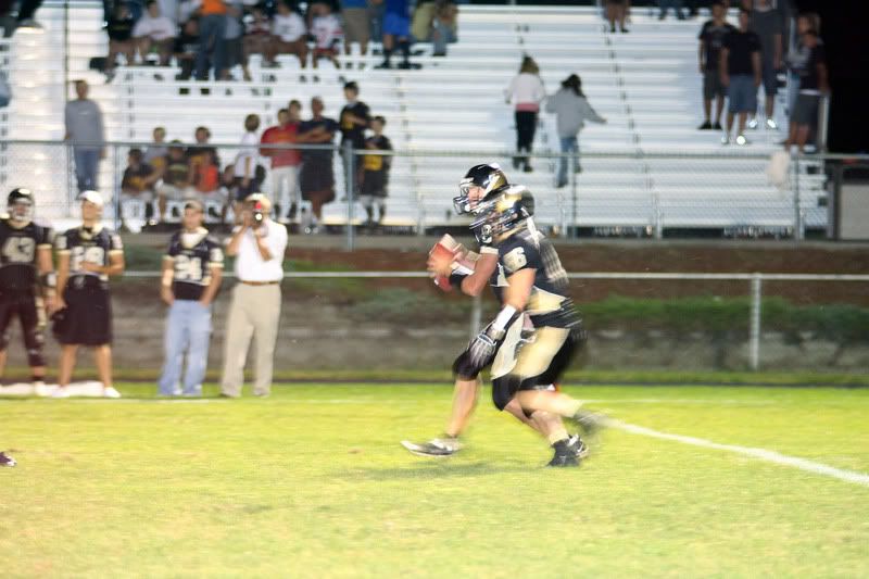

I was in AIServo, and using my 550ex mounted, and trying to shoot at 1/200. I did not stop the action at 1/200th. I was in Tv, not M. I was shooting with the 70-200 f2.8. Anyone care to venture a guess why I couldn't stop them?
IMAGE: http://img.photobucket.com/albums/v179/wiwildwood/IMG_0430.jpg
Exif should be intact.
Is this because I had safety shift on? Would it shift the shutter to compensate for underexposure?

It's actually at 1/25 probably because of safety shift like you said... safety shift has saved me more than once. In this case it gave you some interesting motion blur. The answer to your last question is, yes.

It gave me a huge miss ratio, rather than a hit ratio. I'm turning it off for football, if that's the case.

I saw your post in the other thread about focus issues at 400mm. I suspect this may have been the problem there as well, but take a look at the exif to see for sure what the shutter speed actually was. And yes, the selected AF point only lights briefly in AI servo (when you first engage AF) and then goes out.

If you select an aperture in Av mode or a shutter speed in Tv mode and the camera detects that the selected aperture or shutter speed will result in incorrect exposure it will shift it from what you have set to provide proper exposure. Very useful in wedding photography where lighting can change rapidly.
The downside is that you lose some control over your settings. When used in the right situation it can be a real life saver for those important shots. It's not something I would use for sports photography normally because the lighting is usually fairly consistent. Weddings is where it can really excel.
