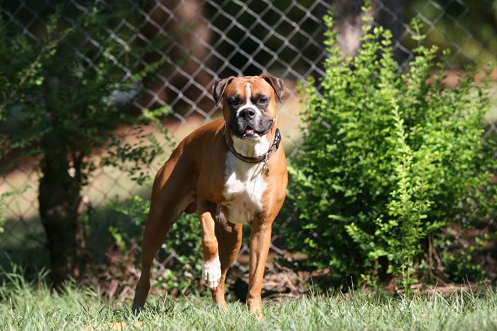

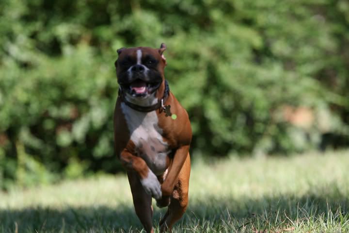

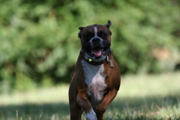

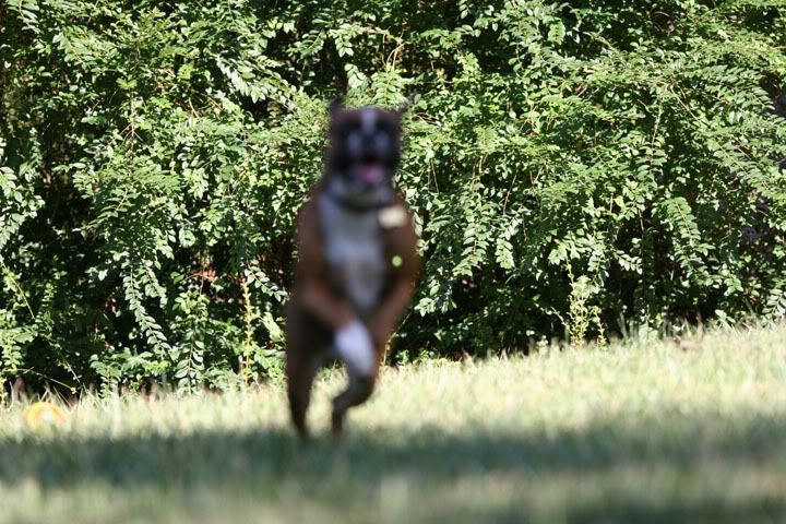

Below are some shots I took as an experiment of my gf's dog. Shutter speed was set at 1,000. ISO 200 and wide apetures to concentrate on the focus points. I was using center point focus point and I put a green dot on the center of the picture. The last picture is to show a static shot to prove the camera and lens do work together.

WAS THIS SINGLE POINT OR ALL POINT's the first 2 are focused on the BG N03 is on the grass right hand corner,No4 looks like it never even tried to focus,No5 looks how it should be.

I hate to say it, but I bet the problem is "I was using center point focus point and I put a green dot on the center of the picture."
I bet the center point was actually just to the side of the dog in these and you focused on the bushes in back..they are more in focus for the most part...the two where you kinda got focus you were probably on the dog but not quite focused yet...
