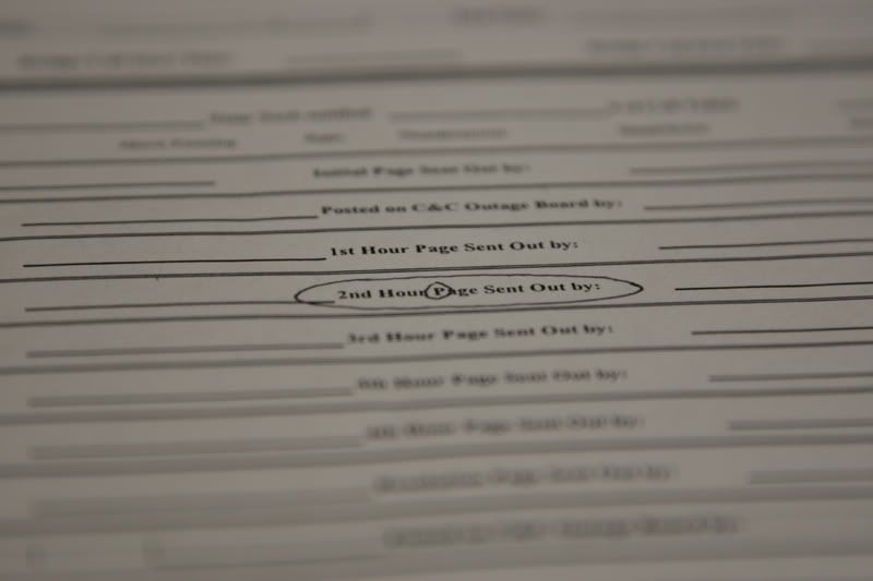

I didnt use a tripod, I am at work and this is the best I can get for now..
Both shots with 24-105
Exif is intact..
Center focus selected, Put on the circled "P"
1.
IMAGE: http://i221.photobucket.com/albums/dd71/mpimage/Misc/IMG_3640.jpg
2.
IMAGE: http://i221.photobucket.com/albums/dd71/mpimage/Misc/IMG_3641.jpg

So what are you unhappy about?
The only thing I can see is that focus is not on the encircled 'P', but considering the target you are using for your test, the AF might just as well have locked onto the two parallel lines just above. In addition, You are not using tripod so even if AF did lock onto the P, you may have moved forward just a bit (we're talking 0.5 cm or so here) before the shutter opened.
These kinds of pixelpeeper tests must be performed carefully if you want to draw any certain conclusions from them. (and not handheld at 1/30 sec with a 105mm lens as in the first pic)

This is not a very scientific test. For 1/30 shutter speed @ 105mm, I'd say it looks as good as it possibly can. As lederK said, I would not draw any conclusions from this test--there are too many variables involved that could adversely affect the end result.

Judging from the sample images, I would say the lens or camera is backfocusing. If the lens was focusing spot on, then you would expect an equal size area in front of and behind the P to be in focus. The sample images show that there is very little in front of the circled P that is in focus, and a lot behind it. Looks like something needs to be calibrated.
Just to verify, you did use the center focus point when doing these tests, correct?

Not really.
That’s called Depth of Field distribution and in most cases there is more focused area behind the point of focus, than in front of it.
It could be precisely calculated for each scenario, but roughly, it goes from 2/3 back, 1/3 front with focus at hyperfocal distance, all the way to almost 1:1 for macro shots.
What we see depends mainly on what we look for.
