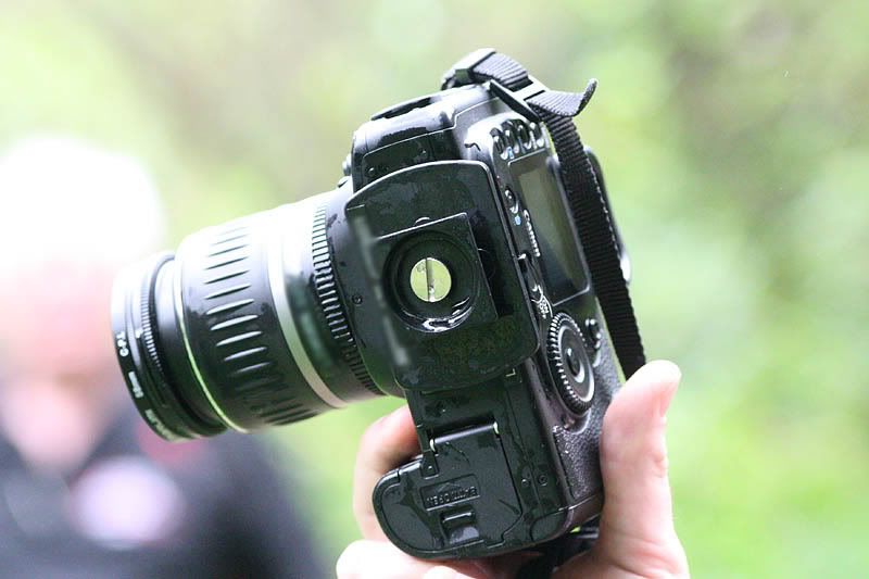

Dec 09, 2007 19:17 |  #5
Of course you have never gotten it wet either Pete:
IMAGE: http://img.photobucket.com/albums/v31/Moppie/petescam.jpg
Sounds like you need a 5D for X-mass :)

Dec 09, 2007 19:39 |  #6
Moppie wrote in post #4471749 (external link)
Ah yes add water to that harsh condition list :rolleyes:
