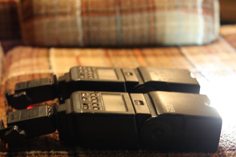

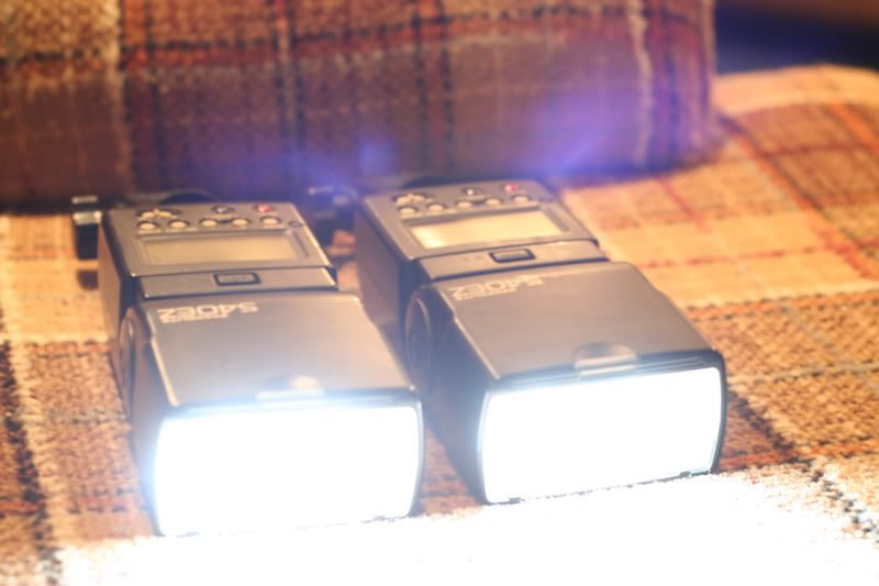

I also just bought two receivers and one transmitter. They worked ok prior to the antenna mod and great after words. I can place a flash at one end of my house and fire it while in another room at the other end of the house. I didn't use the digikey antenna and elected to just use a 3.5" piece of wire instead. It works great and you can't even tell it's modded. I've used it with my 550ex, both 540ezs (as pictured), and an old olympus T20. I plan on buying at least one more receiver, possibly two.

With both 540ezs...

did you shoot faster than your sync speed? reason I asked was the dark strip on the right

I was wondering about that myself. It was shot at 1/200th, and the shot before that is also dark on the right (bottom of the camera frame). However, I have other shots at 1/200th that look fine. Turbodood, can you try taking a set of pictures at 1/200th and see if you sync ok?

It looks like you batteries are getting weak. I use mine at 1/250th for a little while and then I will have to go down to 1/200th and keep going down as the black line shows up. Just the batteries getting weaker is all it is.
