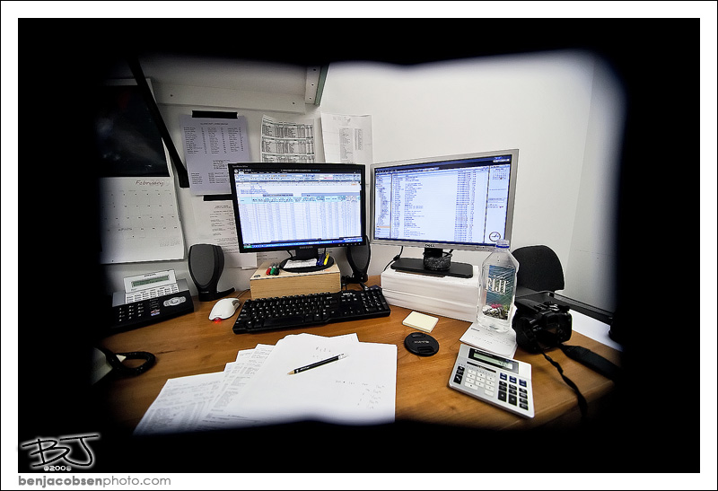

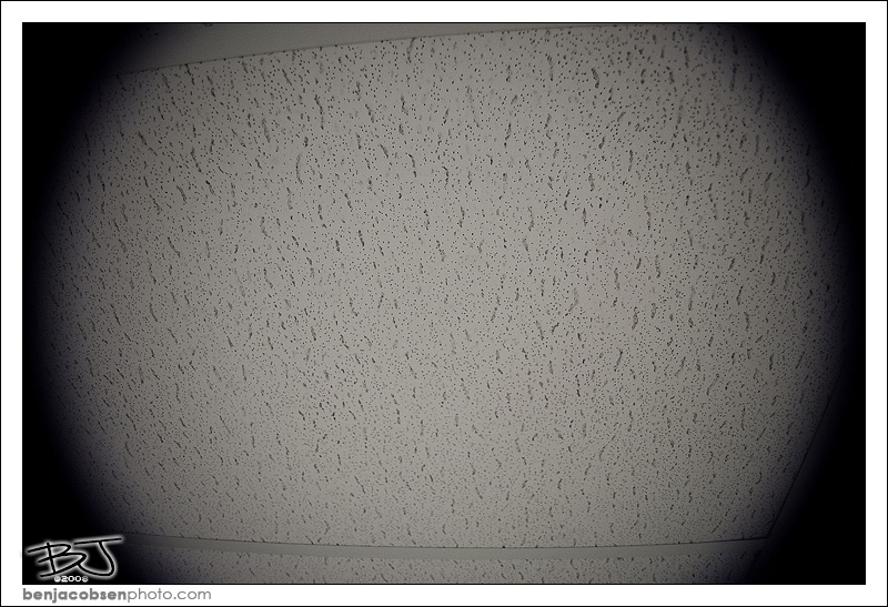

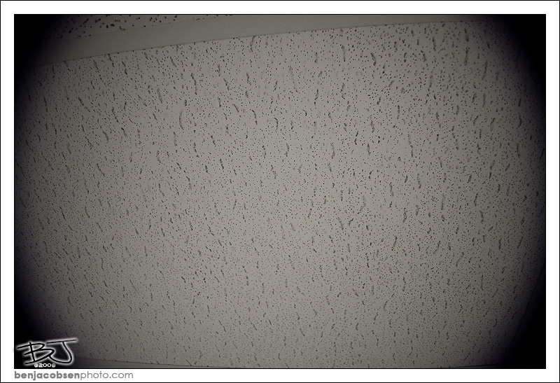

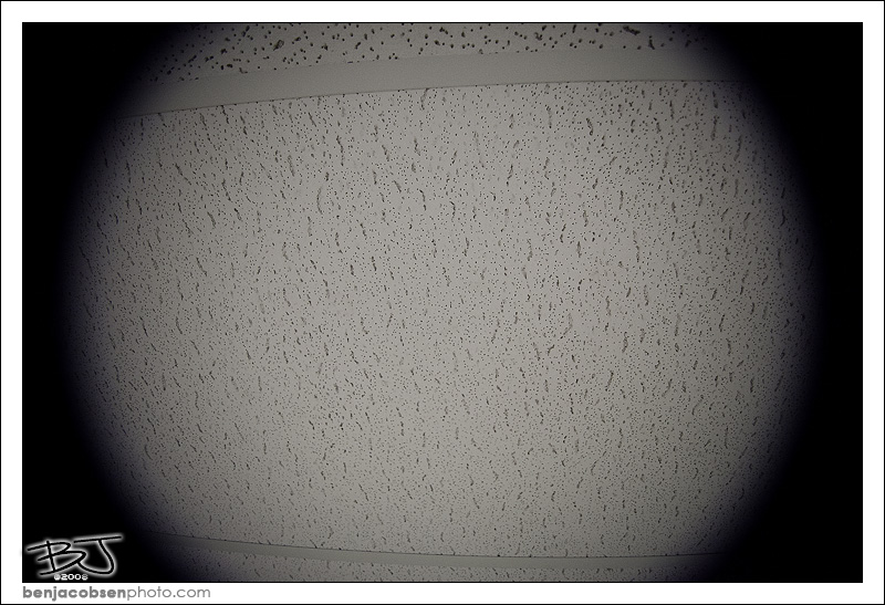

you should really stop saying that unless you can prove me wrong:
jacobsen1 wrote in post #8178857 (external link)
something I did for another thread:
Here it is with the hood on:
then w/o at each whole FL:
11mm
12mm
13mm
14mm
15mm
16mm
15 is close to in the clear, but it's still got black corners, 16 has normal vignetting from a wide open lens (and interestingly, the 5Dii know the lens and corrects for it in camera with it's peripheral whatchamacallit correction).
from that test, 16mm is usable, 15mm IS NOT. So 15.5 might be, but who cares? Sure it's an inexpensive 16mm 2.8 prime, but that's all you're getting...
