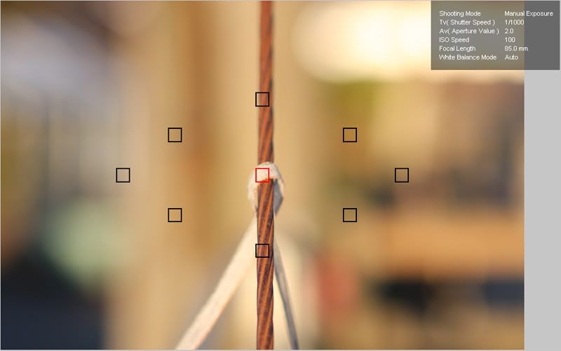

I took random shots around the place and all seemed to be spot on until the last few shots that i took of some rusty looking cable that was at an angle...... i figured this would be perfect and would show up any front/back focus clearly
I wrapped a small piece of white nylon tape around the cable as a marker to focus on and was flummoxed by what happened.... Portrait orientation it focussed absolutely perfectly........
PORTRAIT ORIENTATION
IMAGE: http://img.photobucket.com/albums/v610/wax_monkee75/portraitfullsize-1.jpg
Crop
IMAGE: http://img.photobucket.com/albums/v610/wax_monkee75/portraitview.jpg

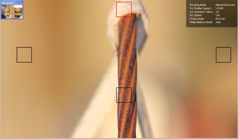

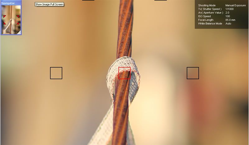

then i switched to landscape and this happened.........
LANDSCAPE ORIENTATION
IMAGE: http://img.photobucket.com/albums/v610/wax_monkee75/Landscapefullsize-1.jpg
Crop
IMAGE: http://img.photobucket.com/albums/v610/wax_monkee75/Landscapeview.jpg
Massive front focussing........ :confused: I tried plenty of shots of this cable in both portrait and landscape - all the portraits were fine all the landscape view shots were front focussed lower down on the cable as they are on the shots posted....... What's going on here??
I plan on taking a few shots tomorrow to see if the problem carries into regular shooting or if it is just a subject that completely throws the camera, and i'll post up the results of that tomorrow....... However i don't see why this subject should be a problem especially as it focussed fine in portrait.....
any help appreciated.....
