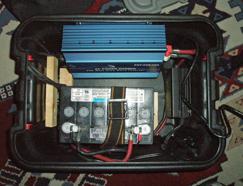

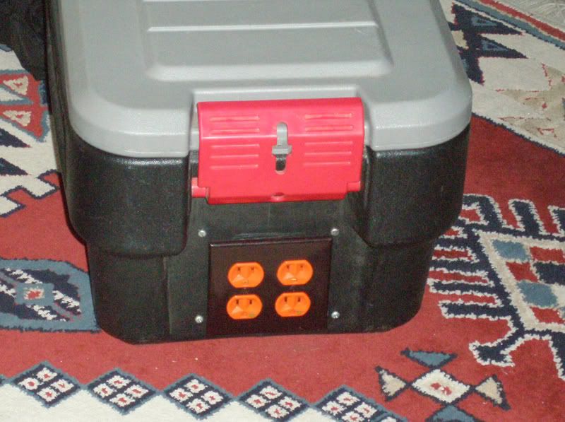

The vagabond has a 20AH battery and 300 W inverter……… I just don’t think that can produce the recycle times and last as long as I need……so I designed my own for exactly the same price as the vagabond …..yes its bigger… yes it weighs a bit more… but it’s better and still decent looking so who cares……
Thought I would share ….
600W (peak 1000) inverter (pure sine wave) + 55 AH battery + 5 amp charger built in (all I need to do is plug it in when its running low!
Tested it with 2 AB1600’s and got exactly the same time (recycle) that I did with wall power ….. **sweet**
Shots from a crapy P+S …. But you get the idea….. +

Looks good. How many flashes will you get out of this all together. And can you post up a full component list please!?

hmmm.... how many flashes..... good question .... i have no idea..... its been powering my whole office (computer, monitor, lamp, Radio) for the last half hour and still going strong..... I'll take it on-location this weekend and see how it does..... component list is as follows ....
55AH AGM battery from (batteriesplus)
600W Samlex Pure Sine Waver Inverter from HYT America
Battery Tender 5 Amp waterproof charger from Batterymart.com
Orange outlets + Junction box cover+ few nuts and bolts
and a plastic box ALA target !

hmmm..... I dont know .... im sure i can find an LCD or something that can display battery voltage ... but the inverter does have an alarm for low voltage.....
Been playing call of duty 4 for the past hour and a half..... it's still going strong ... LOL im really curious to see how long this thing is going to last....

topher04r1 wrote in post #4964156 (external link)
The prices I'm finding are around $140 for the battery and $330 for the inverter. The Vagabond II sells for $300.
What am I missing?

LOL ...i got the battery local for about 130 bucks ... and the inverter online from HYT america for 172 smackers http://www.hytamerica.​com …aspx?Itemcode=P​ST-60S-12A (external link)..... the charger was right arround 50 (ish)

Cool idea... but the battery is 40lbs and the inverter weighs a bit I bet.. so you have to lug 50+ lbs around? I understand you shoot sports mainly and that is okay - but that is huge!
