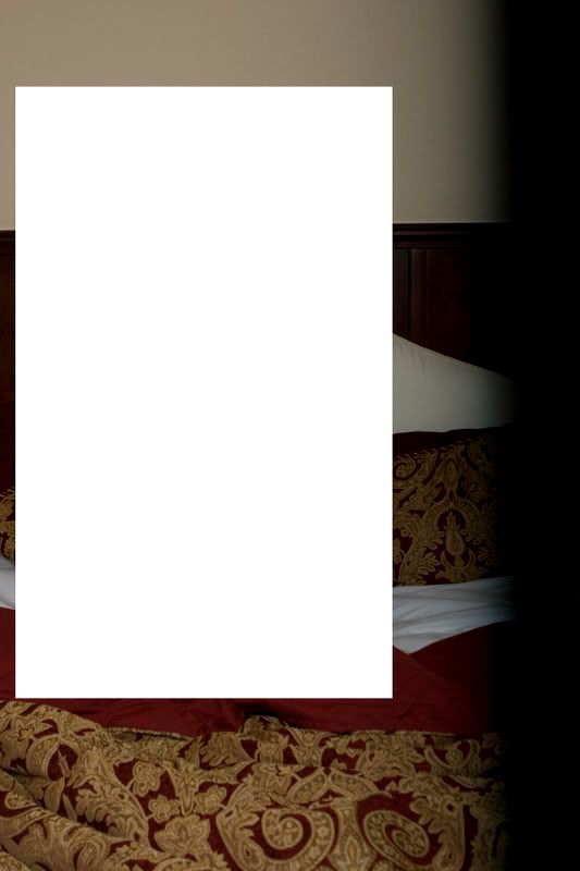

Yesterday I was shooting a boudoir session and part of the way through the session I noticed images that look like the one I have here below. Prior to this happening it sounded as if my shutter stalled or was dragging. I shot about 20 or 30 frames that looked like this (shutter sounded fine after the 1 that sounded weird)then the shutter did the weird thing again and a few frames later it was back to taking normal pictures.
IMAGE: http://img.photobucket.com/albums/v71/prilamai/40dproblem.jpg
I only covered up the client in the image. Any idea? I haven't had the camera but about 3 months. About 3k clicks. It is the weird black along the side that shows up in the images.

I would like to say that you exceeded the flash sync (I believe it is 1/250 on the 40D), but then you'd have a black stripe at the bottom. I've never seen this on the side of a photo before.

Looks like the shutter mechanism is either completely broken or has something stuck in it.
Back to where you got it or to Canon I think.

looking at exif 1/350 is to fast for a flash

But wouldn't it show generally darker all over if the flash was just building up as the shutter fired? Plus it doesn't explain the odd shutter noise

Exif also says internal flash did not fire, but we'll know when the OP tells us if flash was used or not. I see bees in the sig line...so yes if flash was used. 1/250th max.

You exceeded the sync speed of the shutter...nothing more, nothing less. When you bring the camera back within parameters, the black line goes away.

The shutter curtains travel vertically in the 40D, so if the flash sync speed is exceeded, a black bar will appear on the bottom of the frame—if the camera is being held in landscape orientation.. He's in portrait orientation in that image, so the line is going to appear on the side of the image instead of the bottom.
The reason a black line appears is because at the higher shutter speeds, the second shutter curtain begins to close before the flash fires.

Yep, it's the shutter not syncing with the flash unit. You can exceed 1/250th IF you are using Canon flash units and you have the flash unit set to HS flash. But since you are likely using studio strobes you can only to 1/250 max shutter.
