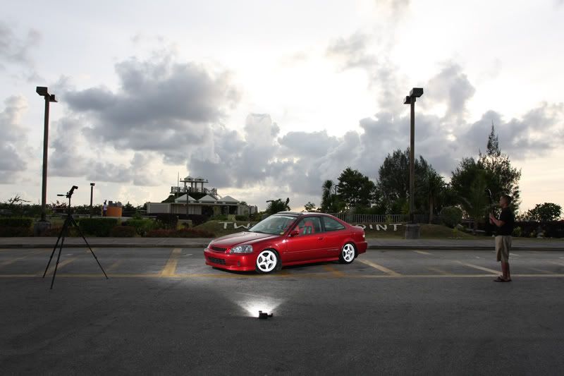

SnlpeR
1,013 posts
Apr 02, 2008 08:46 |  #10
IMAGE: http://img.photobucket.com/albums/v712/SnlpeR2/Juans%20Civic/IMG_5419.jpg
IMAGE: http://img.photobucket.com/albums/v712/SnlpeR2/Juans%20Civic/IMG_5360.jpg
just 3 flashes
easily poratable
ive helped someone haul some studio lights around for shoots and found they are such a hassle

Great shot SnlpeR!!!
