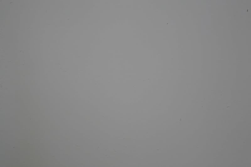

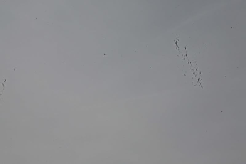

My 5D turned 1 in January and I never cleaned the sensor except with a rocket blower. It was getting very dirty. To send it in to Canon or not? I told myself I'd never touch the thing for fear it would hurt it. But it got so bad I couldn't let it go. I have a wedding this weekend. So, I asked my friend, Mike, who shoots Nikons, but I like him anyway:oops:, had the Sensor Swabs and Eclipse 2 solution and did a simple swipe for me. It took out most of that smear, but it wasn't all gone. I ordered the same from Adorama, and did the deed myself, following instructions, this morning. Here are the before and after shots at f22.
IMAGE: http://i31.photobucket.com/albums/c379/sbastian/IMG_0764_Notclean.jpg
IMAGE: http://i31.photobucket.com/albums/c379/sbastian/IMG_0766_finished.jpg
I will post the wedding shots later, but I thought I'd do a review of the Sensor Swabs & Eclipse 2.
First, the Sensor Swabs were $45 for 12 and the fluid was $12. I put 2 drops of solution on one side tip of the swab and braced myself. I was in a room with great sunlight and could see the sensor completely as I worked. What I didn't expect was that the swab was exactly the same size as my 5D sensor so I had to do the gentle brushing to one side, not just slide it. But the fluid dried instantly and the dirt went onto the swab. You can't use the swab more than one or two swipes or else you put the dirt back onto the sensor, so work quickly. I let it rest upside down for a minute to make sure everything was dry, but it was not necessary. The solution was dry. After doing this twice because there was one stubborn area, the end result was pretty good. I hope this helps. I was so nervous, but glad it's over. Now I won't be so scared next time.

Apr 04, 2008 15:52 |  #2
Nice one Suzie. Boy that was some crud! I'm dreading having to clean the sensor in my 5D but I know it's only a matter of time before I have to bite the bullet and give it a go. I had originally planned on using Digipads as they're a bit less expensive but having seen the results you've got with Sensor Swabs I might just give them a go.

Apr 04, 2008 16:33 |  #4
Great improvement, congrats on going for it.
Maybe I'm just too gutsy, I've done my already with just some cotton swabs, made a huge difference. There was a tiny bit left, but I rarely shoot f22 and I pretty much never shoot plain white oof backgrounds, so I figured I'd never see it.

Apr 04, 2008 18:08 |  #9
Suzie.. A year, yikes!!! And that was no dust bunnie, it was a dust elephant. :) Anyway, great job and yes, it does get easier each time.
picturecrazy wrote in post #5261220 (external link)
... I have a really frustrating time wet cleaning. I get the specks off the middle of the sensor but it all gets deposited on the edge of the sensor. The stupid swab doesn't pick it up! It just moves it to the edge and leaves it there. I HATE cleaning sensors!! argh!!
I have found that a sensor wand wrapped with a pec pad allows for much better edge cleaning. It is smaller and after wet cleaning the sensor surface, I can re-wrap the sensor wand with a clean pec pad and give the edges a once over with a dry pad. This gets the crud out of even the corners.

Apr 04, 2008 18:12 as a reply to  @ gjl711's post |  #10
A pecpad wrapped around a qtip is effective in the corners as well. I also prefer the pecpads on the wand for sensor cleaning.

Apr 04, 2008 18:56 |  #11
I looked at the article in EOS Magazine that said what Canon service centers use. They use a variety of different systems. I just chose this one because it looked easy. No matter what, though, it's worth doing. I don't ever shoot f22, but for a wedding, with a white dress, it will be hard no matter what. I guess the pressure is what caused me to do the job. And it's not totally clean, the edges are not perfect, but I can crop it out if I need to. Just glad I got that smear off. Don't even ask how that happened. ;)

Apr 04, 2008 19:31 |  #14
That one I haven't heard, but I do have to say that when you can see the smear on the sensor, it's really bad.
And the 5D sensor is really large, and you think it would be easy to clean, but you can't see the little particles until you take the white shot on f22.
