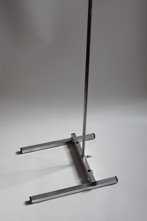

...it’s a little rough but it’s a prototype and my welding could improve...
IMAGE: http://www.anderssonbros.com/photo/Macropod_base1.JPG
This, the base unit, is constructed of steel and very rigid.
It is possible to attach the vertical tube in three different positions

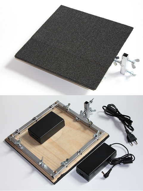

Object plate
IMAGE: http://www.anderssonbros.com/photo/Macropod_objectplate2.JPG
It is made of a steel frame with a wooden board. I have glued some foam rubber on it to provide a non slip surface (this material was originally to be used as sound proofing material for PCs).
The Object plate can be tilted up/down and locked in any angle.
The Powerbox, placed underneath the Object plate, holds the LED lamps in place by the USB connectors and has a 5V regulator built in to provide power to the LEDs.
It is also the distribution point for 12V accessories. A power adapter for 220V/12V is connected to the Powerbox.

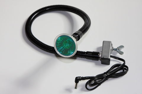

Halogen
IMAGE: http://www.anderssonbros.com/photo/Macropod_halogen1.JPG
When you require a more powerful light you can use the Halogen lamp. It is attached to the Universal mount.
This is also built on a goose neck to allow flexible adjustment. It is connected to the Powerbox which can support Halogen lamps up to 50W.
The construction provide easy access if you would like to switch the Halogen lamp for a different color or power level.

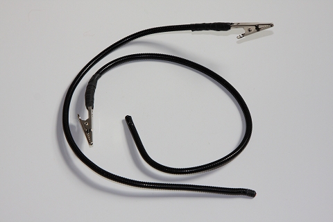

Clamps
IMAGE: http://www.anderssonbros.com/photo/Macropod_clamp1.JPG
Modified USB goose-neck-lamps that provide a good grip and possibility to place the sample or other things in any position. They should be attached to any of the holes on the frame underneath the Object plate.

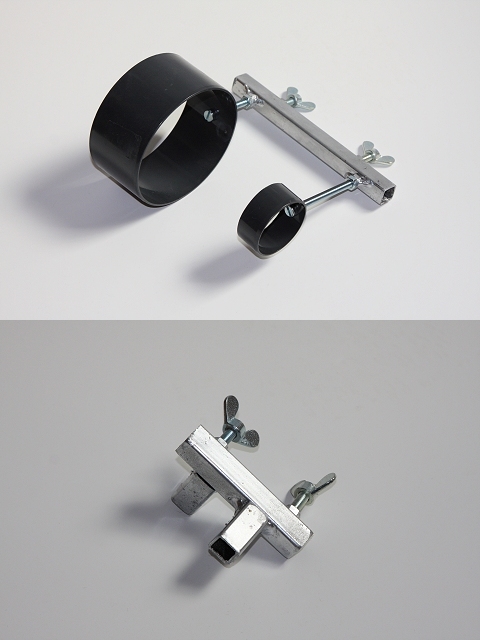

Fluid mount & Universal mount
IMAGE: http://www.anderssonbros.com/photo/Macropod_fluiduniversal1.JPG
Fluid mount is specifically made to allow a bottle with fluid to be placed above the Object plate in a very convenient way. Perfect for the drop shot.
To be able to accommodate different accessories (like the Halogen) I fabricated a simple Universal mount.

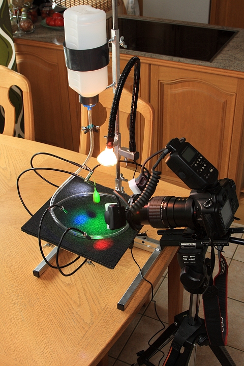

A shot of the complete set up placed on the kitchen table.
IMAGE: http://www.anderssonbros.com/photo/Macropod_kitchen1.JPG

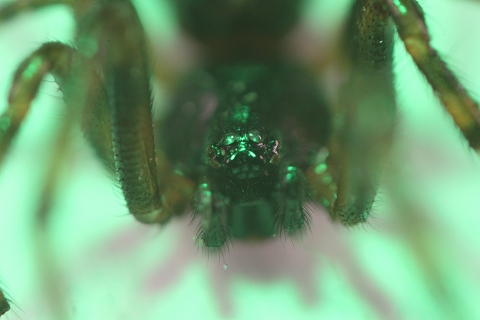

And last but not least a quick test shot of a spider that was struck by the green Halogen light from above
IMAGE: http://www.anderssonbros.com/photo/spider1.JPG

Thanks guys.

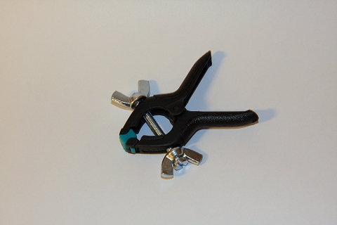

Actually I will try to use this modified glue clamp to adjust the flow.
(you can see it attached to the tube just below the bottle on the kitchen shot)
IMAGE: http://www.anderssonbros.com/photo/Macropod_tubeclamp1.JPG
I'm not sure it will do the trick but we'll see ;)

Candersson wrote in post #5266301 (external link)
Thanks guys.
I've found the best water drip rate control to be a fish tank air hose valve. They are readily available, cost less than $3 and are very accurate and consistant in the drip results.
like this one.

Apr 07, 2008 15:21 |  #12
tomd wrote in post #5278556 (external link)
:idea: Great idea!! Thank you for the tip :cool:
